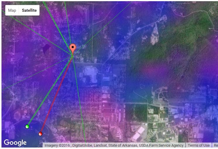

Old 17-Sep-2016, 7:55 PM   #4
You are on the fringe of KOZL coverage:
BUT you location is still in the blue, which is promising:
