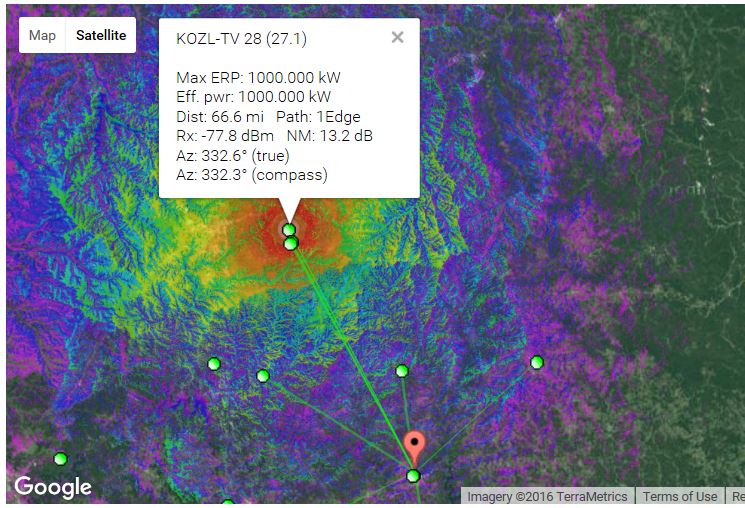

You are on the fringe of KOZL coverage:
http://forum.tvfool.com/attachment.p...1&d=1474138332

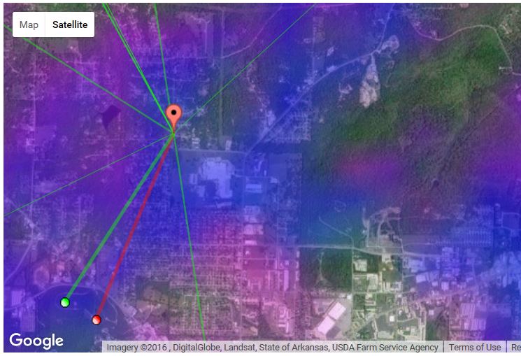

BUT you location is still in the blue, which is promising:
