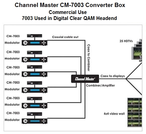

Channel Master has come out with a new tuner, the 7003.
http://www.channelmaster.com/Digital..._p/cm-7003.htm
In theory, it is possible to add its SD analog output from one antenna system to your other system on channel 3 or 4 with the modulator in the 7003.
It is also possible to add its HD output to the other system with a modulator on an unused UHF channel. I haven't done either.
I'm not sure I follow that, sorry. I mean the part of how I get two antenna systems to work on it. Or do you mean combine two STBs?
I went to that link, and tried to keep up, but I don't even know what a modulator is. Those guys were talking about stuff I never heard of
