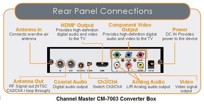

Channel Master has come out with a new tuner, the 7003.
http://www.channelmaster.com/Digital..._p/cm-7003.htm

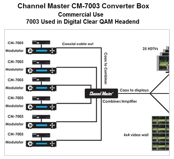

In theory, it is possible to add its SD analog output from one antenna system to your other system on channel 3 or 4 with the modulator in the 7003.
http://forum.tvfool.com/attachment.p...1&d=1476488730
It is also possible to add its HD output to the other system with a modulator on an unused UHF channel. I haven't done either.

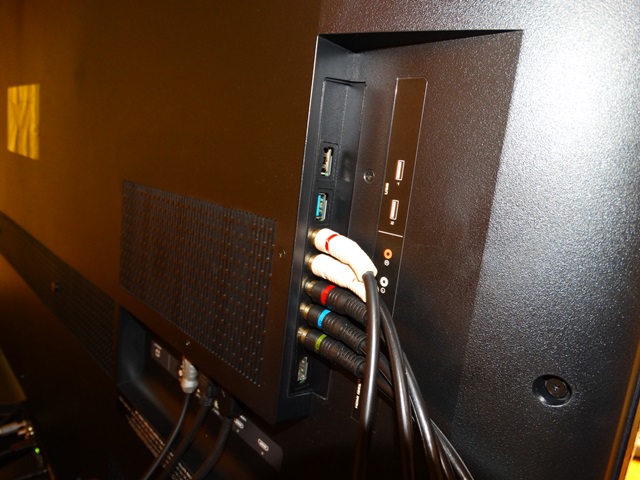

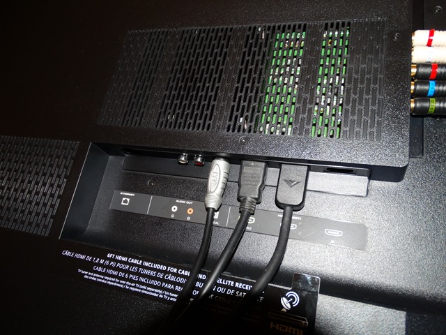

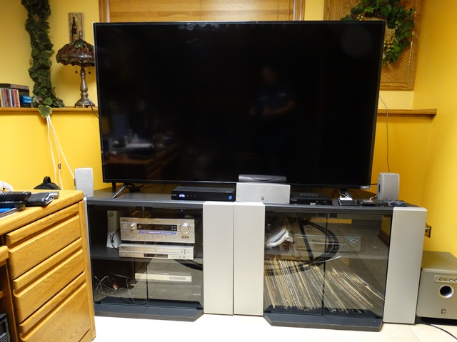

The new Vizio part # E70u-D3.
Good news! :
It has 4 HDMI ports, One composite Video 5 cable input, one USB 3.0, one USB 2.0, One Ethernet, 802.11 dual band wireless, one optical video, Red/white RCA output, 8 core processor, whatever that means.
http://forum.tvfool.com/attachment.p...1&d=1476593254
http://forum.tvfool.com/attachment.p...1&d=1476593477
http://forum.tvfool.com/attachment.p...1&d=1476562944
http://forum.tvfool.com/attachment.p...1&d=1476562966
http://forum.tvfool.com/attachment.p...1&d=1476562980
Attachment 2379
Attachment 2380
Attachment 2381
The salesman tried awfully hard to get me into the M or P series and really tried to dismiss Vizio as a second rate display device. He tried to push me into a $4000 55" Sony, that was nice, the black level was incredible. But that wasn't what I came in for.
But I was also impressed with the E70u-D3 with the 4K input that was showing some Ultra Hi Def video of Chicago at night and I couldn't stop staring. It was good enough for me. $1295 + tax and away I went.
