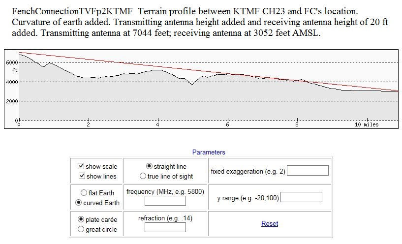

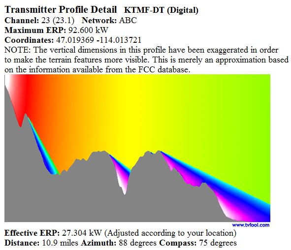

The Stacker seems to be working. If there was a problem with the UHF section, you probably wouldn't be able to receive K14IU, but KTMF is weaker and has a 1Edge path because of terrain interference.
Notice that only about 30% of the max power is aimed in your direction because of the directional pattern of the transmitting antenna.
Using other profile software:
You can see how the terrain might interfere with the signal on its way to your antenna. The tvfool report simulation doesn't take into consideration ground clutter like trees or buildings. UHF signals can't diffract over terrain obstructions as easily as VHF signals.

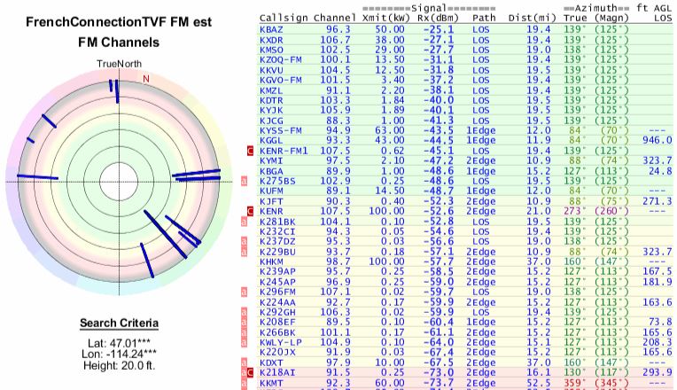

In post #2 I asked if you had tried a scan for KTMF without a preamp, because of the possibility of partial overload, which affects the weak signals before it affects the strong signals.
Your strongest signal is KUFM with a Noise Margin of 52.7 dB, and a signal power of -38.1 dBm. If you add the antenna gain of say 12 dB, you are at NM 64.7 dB and signal power of -26.1 dB, which might be too much for the LNA200 or the tuner.
ADTech hasn't yet done any overload tests for the LNA200, but he did do a test of the LNA100 using an Eclipse antenna and a spectrum analyzer in a strong signal area.
Eclipse antenna, no preamp:
With LNA100 preamp. Notice how the weaker signals are damaged first because of the rising noise floor from IMD (Intermodulation Distortion) products that reduce the SNR of the weak signals:
This is what the signals look like with a high quality preamp that is resistant to overload:
The things you might consider trying:
1. Move the antenna to a location that has a better signal for KTMF
2. Use a preamp that tolerates overload and has a low noise figure to improve the system noise figure as much as possible
3. Elevate the front of the antenna because the signals are coming over a hill
4. Use a separate UHF antenna like a DB8e or 91XG (which has a tilt feature) to replace the UHF section of the Stacker and combine it with the Stacker with a UVSJ.
5. Add an FM trap because you have some strong local FM signals that might interfere with TV reception. See attachment for FM Fool report for you estimated location.
http://www.radioshack.com/radioshack...p/1500024.html
I have no idea if any of these ideas will actually improve the reception of KTMF, but the are all I can think of now.

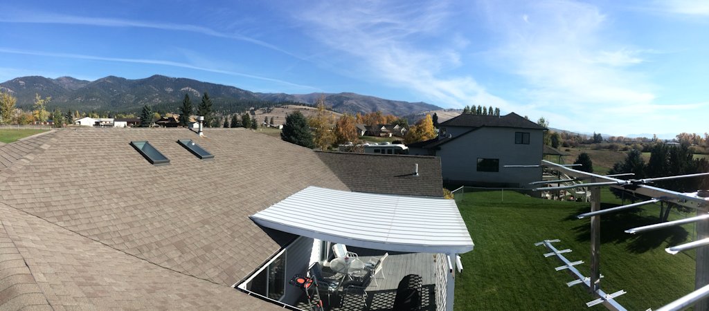

Hi Folks,
I got up on the roof this morning and played around for a couple hours with things.
Disconnected Pre-Amp
- No change at current mast location (0 strength)
- Found a portion of the house above the garage where it did receive signal (~40% strength) enough to pick up football with no issues.
Re-connected Pre-Amp in this new location
- Increased strength by ~10% (to 50+%)
I then moved incrementally around the roof varying the antenna height/orientation. This exercise demonstrated:
- A band (10-20') wide on the roof where I picked up signal. This band tended to be weaker the higher I raised the antenna from the roof, with a sweet spot being ~3' above the roofline. As I got to the fringe of the area the dropoff was quick from ~30% to 0%.
Since the Pre-amp increased my strength previously I left it connected and disconnected the VHF antenna. I then incrementally moved around the roof with the antenna. Strength levels were similar to what they were when both were connected; however there may have been a slight gain.
Upon completion of the testing I re-installed the antenna on the existing mast and took photos from two vantage points that are attached.
Existing Mast Location (Current Mast Location.jpg)
Where I picked up KTMF (Pickup Location.jpg)
Based upon my experiments I'm thinking my set up has some combination of the following:
1) Poor mast location for KTMF
2) Inadequate UHF antenna
3) Potentially inadequate gain/pre-amp
Moving forward it would appear I could
A) Install a mast where I can pick up signal (This option would require a lot of work on my part, require mounting/runs on a roof that may need to be replaced soon, and could upset neighbors)
B) Experiment with a different Pre-Amp to increase gains at current location
C) Experiment with merging 2 different antenna signals at current location
Options B & C have the definitive risk of doing nothing if current mast location is in a blind spot.
In performing the tests I found it very strange how there was such a limited window (with the existing antenna) where I could reliably get signal, and that raising the antenna much above the roof-line seemed to generally hurt reception.
I guess my questions are:
1) Is there a good explanation on why raising the antenna would hurt reception? (I thought KTMF was LOS, for which higher is better)
2) What is the likely hood I can pickup signal at my existing mast location by playing with antenna/pre-amp choices?
3) Is there any additional tests that I can do with my existing equipment to help provide clarity?
Again, I appreciate all the time and help that folks have put in to this point.
FC
FrenchConnection is offline   Reply With Quote
Old 17-Oct-2015, 9:35 PM   #18
Thanks for the test results and the interesting wide-view photos.
Did you insert a UVSJ for Test No. 1 in post #8?
If you use the UVSJ for that test, you don't need to disconnect the VHF section of the Stacker because the UVSJ attenuates VHF and FM.
The signal wavefront is non-uniform and has layers of weak and strong areas. One possibility is roof reflections of the signal that add to the direct signal that enhance it if they arrive at the antenna in phase.
Another location sounds better; sometimes the best location for the signal isn't the most convenient. But don't give up on the present location until you have completed all the options suggested by Mike.
Old 17-Oct-2015, 11:12 PM   #19
Tower Guy
Location: Delmar, NY
Posts: 1,236
Your existing antenna location has the roof in the foreground below the antenna. The new location has bare ground. The signal is reflecting off the ground and reinforcing incoming the signal.
To understand why, read this: http://www.hdtvprimer.com/antennas/siting.html
Especially this section:
"The ground reflection can be very helpful. Assume the power in the incident wave is P. If the reflection is 100% efficient, you might expect the power in the overlapped area to be 2P. But instead it will vary from 0P to 4P. (Power is the square of voltage. Where the voltage doubles, the available power goes up by 4.)
If you can put the antenna in the most intense spot, it will collect 4 times as much signal as with no ground reflection (assuming a 100% efficient ground reflection)."
