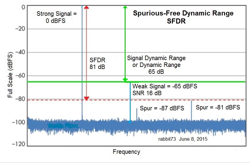

I could also use some help with how to avoid signal overload with respect to using a high-gain system for both the remote stations as well as the powerful local channels.
Yeah, that's one of the problems.
CBOT-DT is your strongest signal with a Noise Margin of 64.5 dB, even before adding the 7698 antenna average UHF gain of 13 dB.
You will need an antenna like the 7698, 91XG, or DB8E for WNPI and a preamp which would be overloaded by your local signals. The dynamic range between CBOT and WNPI is 68.6 dB. To this you must add 16 dB for the SNR needed by WNPI to get the required SFDR (Spurious-Free Dynamic Range) of 84.6 dB. This will not work because the strong local signals will create spurious signals in the preamp itself from IMD (Intermodulation Distortion) that will probably wipe out the weak signals including WNPI.

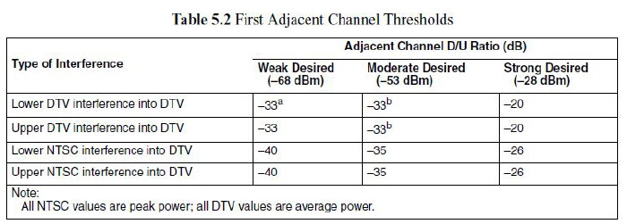

Yet another problem is that WNPI has adjacent channel interference from CICO-DT on real channel 24, which is 62.9 dB stronger.
ATSC Recommended Practice:
5.4.2 Adjacent Channel Rejection
The receiver should meet or exceed the thresholds given in Table 5.2 for rejection of first adjacent-channel interference at the desired signal levels shown above the columns therein.
62.9 dB is much greater than 33 dB.
