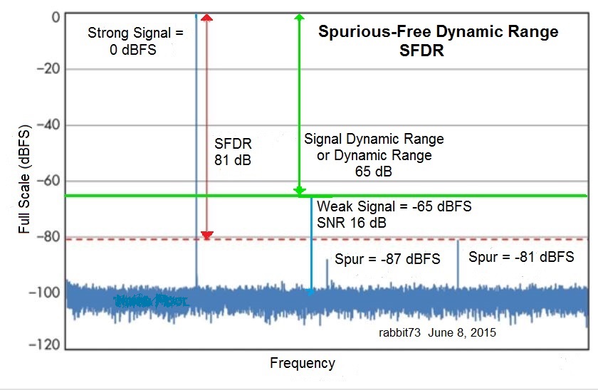

CBOT-DT is your strongest signal with a Noise Margin of 64.5 dB, even before adding the 7698 antenna average UHF gain of 13 dB.
http://forum.tvfool.com/attachment.p...1&d=1434751838
You will need an antenna like the 7698, 91XG, or DB8E for WNPI and a preamp which would be overloaded by your local signals. The dynamic range between CBOT and WNPI is 68.6 dB. To this you must add 16 dB for the SNR needed by WNPI to get the required SFDR (Spurious-Free Dynamic Range) of 84.6 dB. This will not work because the strong local signals will create spurious signals in the preamp itself from IMD (Intermodulation Distortion) that will probably wipe out the weak signals including WNPI.

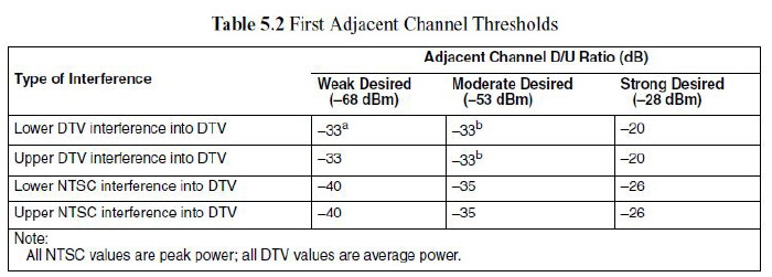

Yet another problem is that WNPI has adjacent channel interference from CICO-DT on real channel 24, which is 62.9 dB stronger.
ATSC Recommended Practice:
5.4.2 Adjacent Channel Rejection
The receiver should meet or exceed the thresholds given in Table 5.2 for rejection of first adjacent-channel interference at the desired signal levels shown above the columns therein.
http://forum.tvfool.com/attachment.p...1&d=1434754860
62.9 dB is much greater than 33 dB.
