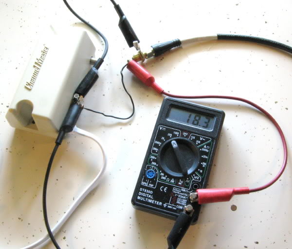

Here I'm measuring the output voltage of the CM0747 power supply/inserter under load. It is necessary to have access to the center conductor to measure the voltage and current, hence the 18 gauge hookup wire:

The current carrying ability is determined by the contact resistance, as it is in switches. You can measure the contact resistance by using what is called a 4-terminal resistance measurement which uses a constant current and a measurement of the voltage drop. Ohm's law then gives you the contact resistance.
The simple way is to measure the voltage delivered to the preamp to see if it is sufficient for proper operation. This becomes more important with long runs of coax. RG6 with a solid copper center conductor has less DC voltage drop than RG6 with a copper coated steel center conductor. The TV signals use just the surface of the center conductor; this is called the "skin effect." The DC current for the preamp power uses the whole cross-section of the center conductor.
