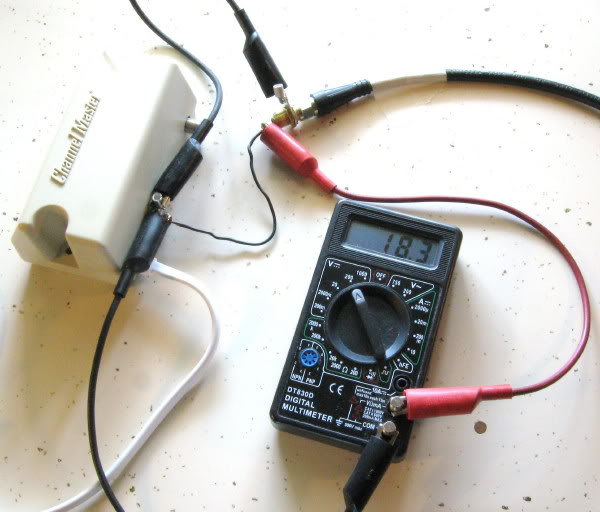

I have bought some miserable F81s. Some don't grab the center conductor very well; others don't even allow the center conductor to enter!
I test every one before I use it by inserting a short length of 18 gauge solid copper wire to see how well it grabs it. That's the same gauge as the center conductor of RG6.
Here I'm measuring the output voltage of the CM0747 power supply/inserter under load. It is necessary to have access to the center conductor to measure the voltage and current, hence the 18 gauge hookup wire:
http://forum.tvfool.com/attachment.p...1&d=1416169141
The photo is from this post:
