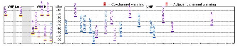

I hope this is what you want.

AS the other question askers do. Do this --> http://forum.tvfool.com/showthread.php?t=4 Do not post separate pictures , post a live and active radar report. This is not information about your antenna this is information about what the others are doing , they are not providing information that is useful until it's point out to them Point Blank. It is OK to provide useful information and a radar report that can be worked with , http://forum.tvfool.com/showthread.php?t=1335 , http://forum.tvfool.com/showthread.php?t=1242

The newbie status is not working , recent question askers have been told to post a useful radar report , reading them -- you know what needs to done.

I suggest a Winegard HD7695P antenna or ChannelMaster CM 2018 antenna or Antennacraft HBU44 . . And Rotor Channel Master CM9521A Mounted on the roof. This will get you all of the digital channels to the east and south , all the way down to WFFF-DT 43 FOX in the channel list. Read and understand this about , Real Digital Tv Channels , Virtual Digital Tv Channels , Analog Tv Channels. forum.tvfool.com/showthread.php?t=695 The same thing applies in Canada.Here is how to point Tv antennas , Here is how to point Tv antennas , http://www.kyes.com/antenna/pointing/pointing.html

As you can see the Tv stations are at different widely spaced directions. Tv antennas are directional in reception and the Tv stations are so widely spaced that a directional antenna will not receive them all pointed in one direction , so the tv antenna needs to be rotated to point at the tv stations. There is another way of doing it with 2 antennas and no rotor. One antenna in the attic is pointed to the east the strong stations and the other antenna on the roof is pointed at weaker stations to the south. And the two antennas are 2 separate antenna systems , 2 separate coax to the Tv with a remote control A/B antenna switch to switch the Tv to antenna A and antenna B. . OR you could use a indoor antenna to watch the channels in green. Here are the indoor antennas , http://forum.tvfool.com/showthread.php?t=233 . . . Read the other question askers questions and understand that they are getting the truth about there questions. Here is how to point Tv antennas , What is interesting is this and other Common Information that is True is given time after time after time after time after time , again and again \and again and again and over and over and over and over and over , repeatedly , repeatedly and repeatedly and repeatedly and repeatedaly , http://www.kyes.com/antenna/pointing/pointing.html
