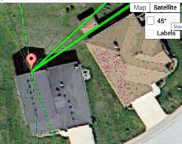

Would those options not run into similar issues maybe with different objects or even the tree that ADTech spoke of. Just wondering your thoughts...
Probably not, because they would be using the same green lines as the eave mount, but just a little lower down on the rear of your house. Testing would tell you right away.
Just got another idea:
What would happen if you used the 5 ft mast section that you just bought to raise the C2V 5 ft higher on the satellite mount? No "ugly" tripod needed, but if it doesn't fit it wouldn't work.

My wife is wanting to know how much higher the mast would be sticking up above the roof if we go with the eaves mount. I wasn't sure so I thought I'd ask.

Short answer is "As high as it takes".
We are not able to stand on your rooftop and see what the precise distances and heights might be. The antenna will work best when it gets a clear and unobstructed view in the direction the signals are coming from.
Old 23-Nov-2014, 12:16 AM   #144
Higher than what? If you mean higher than the roof itself, it would be something like the attachment. If you mean higher than its present location on the garage roof, then the C2V on the garage roof is about as high as the top part of the windows of the 2nd floor at the back of the house.
The eave mount itself at the back of the higher roof on the west side will not show from the street. Only the C2V antenna and the upper part of the mast will show.
It is a different case for the C2V antenna on the garage roof, because of the house next to you on the east side. You would, as ADTech says, need to raise it high enough for the signals to clear the peak of their roof, which might be too obvious and unattractive.
You don't have a signal clearence problem, as far as I can tell, with the eave mount on the back of the higher roof where the eave mount would be fastened. That point has an unobstructed view to the NE, which is why that would be the best location for the C2V.
If you mounted the C2V on a mast on the rear deck, then nothing would show from the street, and the reception at that location might be satisfactory, because it looks like that is also an unobstructed place. The antenna on the deck would become a conversation piece for "bragging rights" about free high quality TV pictures and no cable bill.
The 91XG for Fox is doing well on the garage roof, as proved by your attenuator test to measure the "fade margin." After studying the photos of your house, it looks like the 91XG is also about as high as the top of the upper floor windows at the back, so even if it were moved up to a slightly higher location, the improvement wouldn't be much, if any. That is why we said leave it where it is on the garage roof.
Yes she meant higher than the roof itself.
Are you talking about using the 5 or 10 foot mast? I'm not quite sure how that would be mounted on the deck (and also figured other houses or objects would prevent the C2V from having an unobstructed view from there).
Thank you.
10 ft, thinking that it could be supported by the railing at the NW corner of the deck, but only after you make a test to see if that would really work.
The 10 ft mast is needed there for the greater height for the signals and so that the antenna would be above the head of anyone on the deck for safety.
What houses or objects are you aware of? I see some in the satellite view, but they don't look too serious. A test setup would tell you if there were a problem. I think you are worrying too soon.

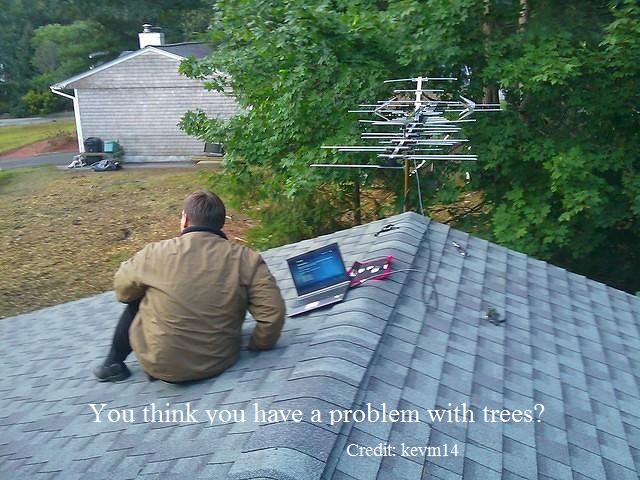

In the photo above Kevin is using a WG 7697P. If you want to read more about his tree problem:
http://www.avsforum.com/forum/25-hdt...l#post17280909
http://www.avsforum.com/forum/25-hdt...l#post17283385
http://www.avsforum.com/forum/25-hdt...l#post17297708
It is true that the eave mount gives you the highest point. If the C2V there works well, your problem is solved. If the C2V works well only for the UHF signals, but there is still a problem with 10.1, then you will need to put a UHF/VHF-hi combo antenna, like the Winegard HD7694P, there.
If your test there doesn't work because of obstructions, then your only alternatives would be a tripod on the upper roof or a tower in the back yard. Both of them would be difficult to do.
If you then reach the point where you have no more options to improve the signals from the NE for the Roamio, then you are left with Plan B. That plan would be to demote the Roamio to a secondary role for recording only. The antenna coax downlead from the AC7 would be connected to a 4-way splitter that would feed the three TV tuners and the Roamio.
