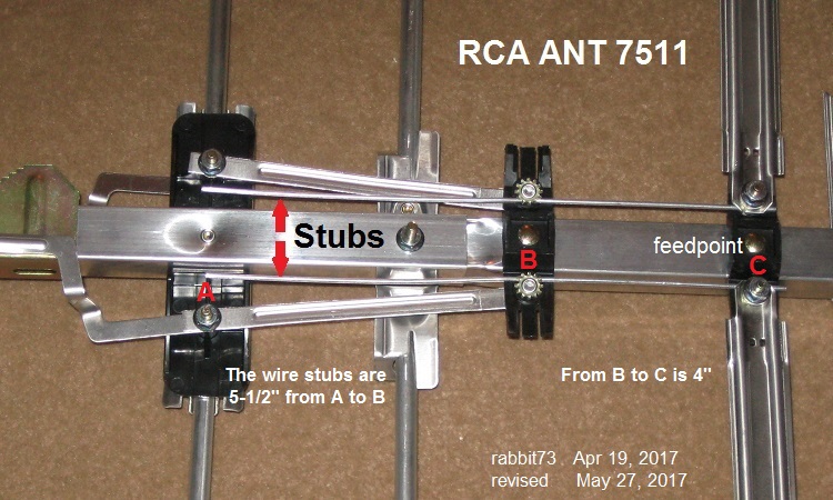

In the RCA ANT7511, they are attached 1/4 wavelength away from the UHF feedpoint, B to C:
There are only two wire stubs on the 7511, which really isn't sufficient to cover the whole UHF band. The wires with one end not connected are a little longer because they aren't as wide as the flat strips. The 751 uses two sets of flat wide stubs to cover the UHF band; much more effective.

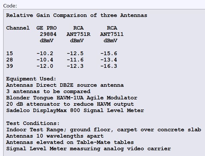

If you get the 7511, it will work, but not as well as the original 751. The 7511 has less gain, but you probably will not notice the difference in strong signal areas; it might make difference with weak marginal signals.
