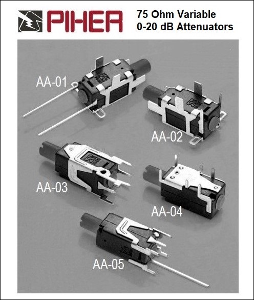

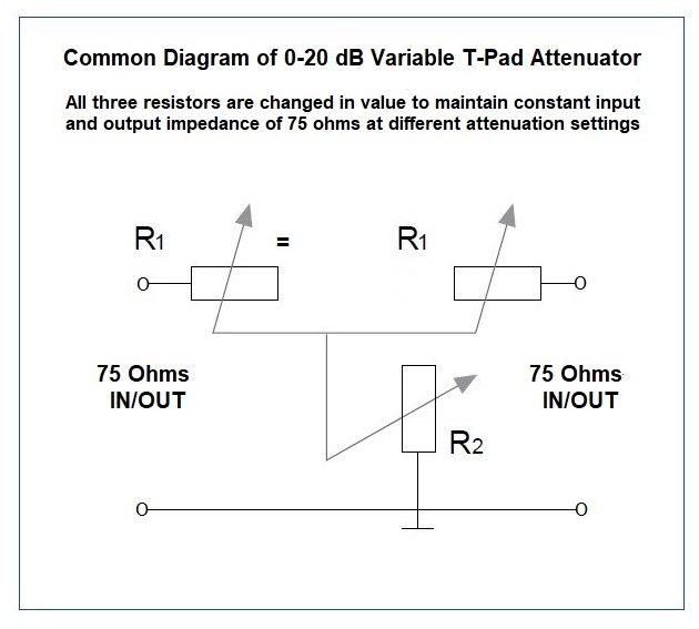

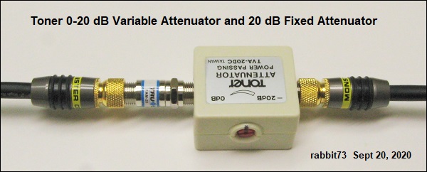

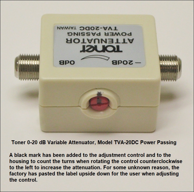

I ordered a Mediasonic HW-150PVR and a Toner 0-20 dB Variable Attenuator to see how they would do at estimating the strength of a TV signal.

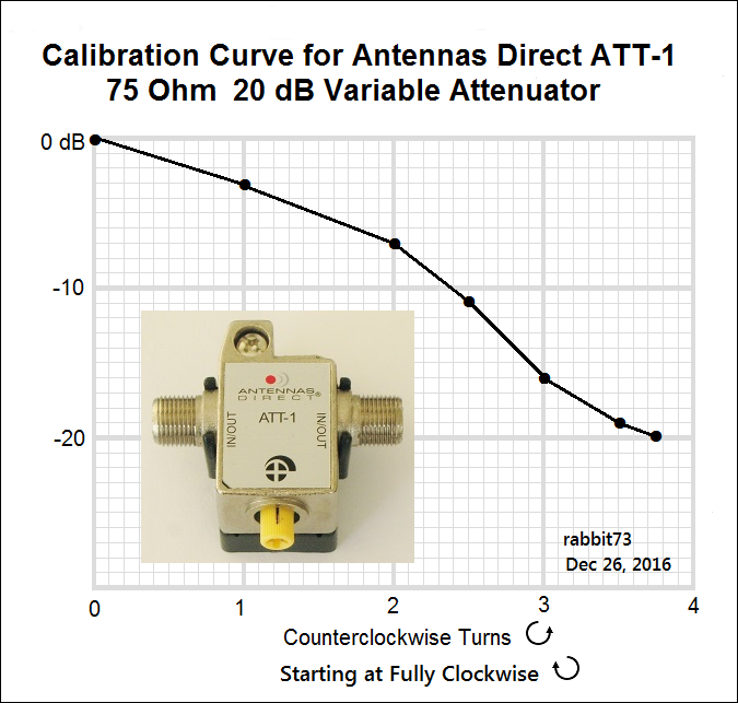

I had previously used a 0-10 dB step attenuator, but they are expensive; I was lucky to find a good used one. I'm trying to find the least expensive equipment to do the job.
I had also used an Antennas Direct 0-20 dB Variable Attenuator, but they have been discontinued along with their FM filter.

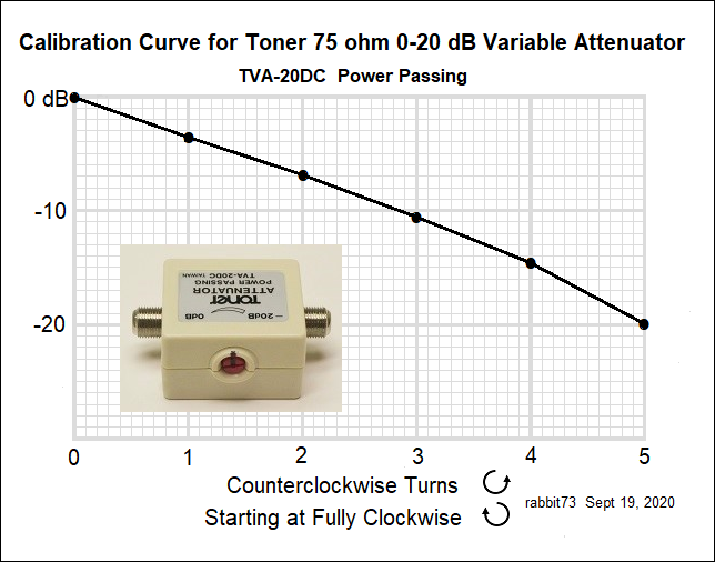

Since the AD ATT-1 was no longer available for others to buy, I made a calibration chart for the Toner attenuator:
I don't know why the factory pasted the label on upside down.
I put a black mark on the knob and on the housing to be able to count the number of turns as I rotated the shaft counterclockwise with a screwdriver to increase the attenuation to dropout.
This was the setup:

                    Fixed       Variable                      SDR
Ant > 25 ft RG6 > Attenuator > Attenuator > 4-Way Splitter > HW-150
                    20 dB    at 1-1/2 turns                   SLM*
                                  5 dB                   75 ohm terminator
* SLM is Sadelco DisplayMax 800 Signal Level Meter

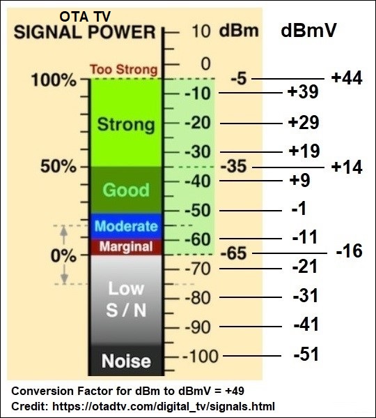

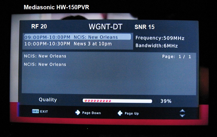

To find the signal strength of Channel 20, I added the attenuator setting to the average tuner dropout point of -85 dBm:
-85dBm + 25 dB = -60 dBm
To confirm the method, my Sadelco DisplayMax Signal level meter reading was -11.9 dBmV = -60.7 dBm
(Since I used a 4-Way splitter, the signal before the splitter was 7 dB stronger. I put a 75 Ohm terminator on the unused port because without it, the outputs weren't equal.)
This method works best on UHF. On VHF, where the noise level is higher, dropout will be higher than at -85 dBm.
The Thermal Noise Floor for a 6 MHz wide TV signal is about -106 dBm.
The Noise Figure for the average tuner is 6 dB:
-106 dBm + 6 dB = -100 dBm
To that we must add 15 dB to allow for the minimum required SNR for the TV signal:
-100 dBm + 15 dB = -85 dBm
However, if the ambient noise is stronger than the internal noise of the tuner, the tuner Noise will be buried in the ambient noise.

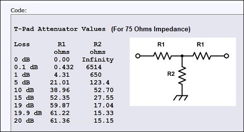

Review of Toner 0-20 dB Variable Attenuator

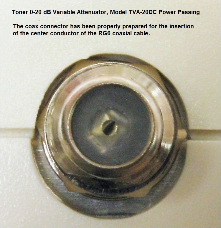

I ordered two of the Toner attenuators in case one was defective. One of them had a coax connector with insulation that hadn't been completely removed, making it difficult to insert the center conductor of the RG6 coax.
I removed the excess insulation with a drill bit held in my hand; the coax was then able to be properly inserted.
I still haven't figured out why they would paste the label on upside down.
It's important to check the female coax connectors to see if they make good contact with the center conductor of the coax:

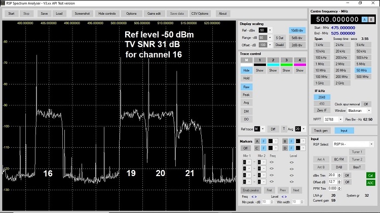

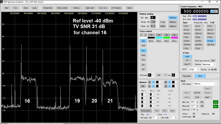

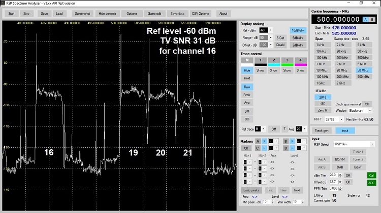

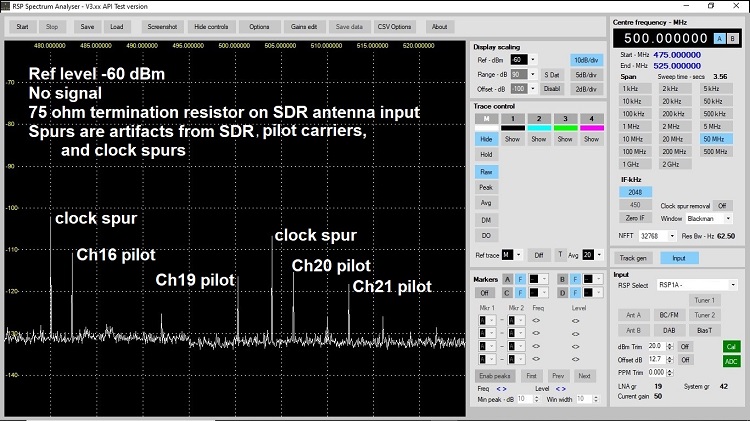

I did some additional tests with the SDRplay RSP1A and the RSP Spectrum Analyser (British spelling) software.
It seems that it is necessary to properly set the Reference level of the RSP Spectrum Analyser. If you set it too high, part or all of the signal will be buried in the noise.
The RSP Spectrum Analyser tries to simulate what a real spectrum analyzer does. You have to be careful with the Display scaling settings to get a correct representation of SNR. Manual:
https://www.sdrplay.com/docs/RSP-Spe...lyser-V1.1.pdf
Setting RSP Spectrum Analyser Reference Level
Reference Level
A common error is a complaint that signals with a 40-50 dB SNR as displayed on SDRuno, shows a signal barely breaking through the noise floor on the analyser. In almost all cases, AGC is enabled on SDRuno, and the LNA gain reduction slider set at a low gain reduction value resulting in a lower noise floor. IF gain reduction will be whatever the AGC system sets it at.
Conversely, the analyser is usually set at a high reference level of somewhere between -30 to+10 dBm, has a very high noise floor and sees little or no signal above the noise. This is usually caused by the user attempting to use the reference level control to position the trace within the display area, instead of using the range and offset controls provided for this purpose.
The reference level should initially be set to around -80 dBm, while ensuring the ADC is not overloaded and spurious signals are not generated. This will give maximum sensitivity and a lower noise floor. Increasing the reference level towards 0 dBm will result in an increasing noise floor, and depending on signal level, may result a lower S/N ratio. Use the range and offset controls to scale and position the display as required.
An example:

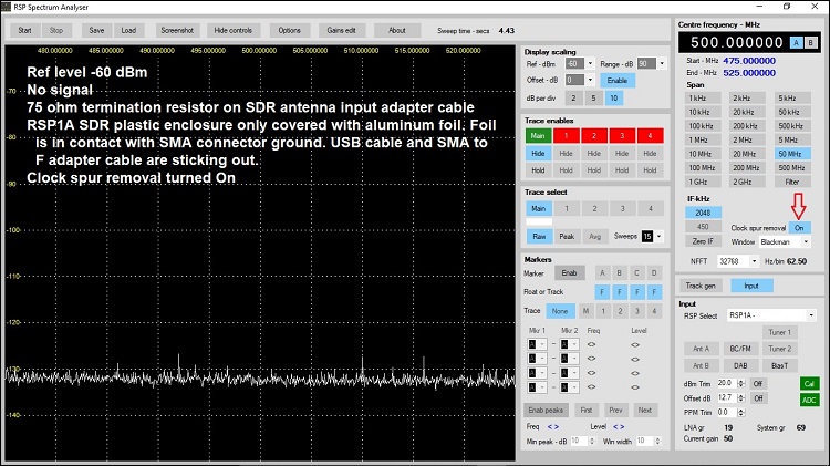

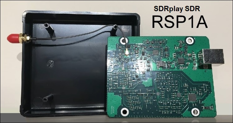

Testing for spurs:

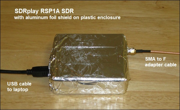

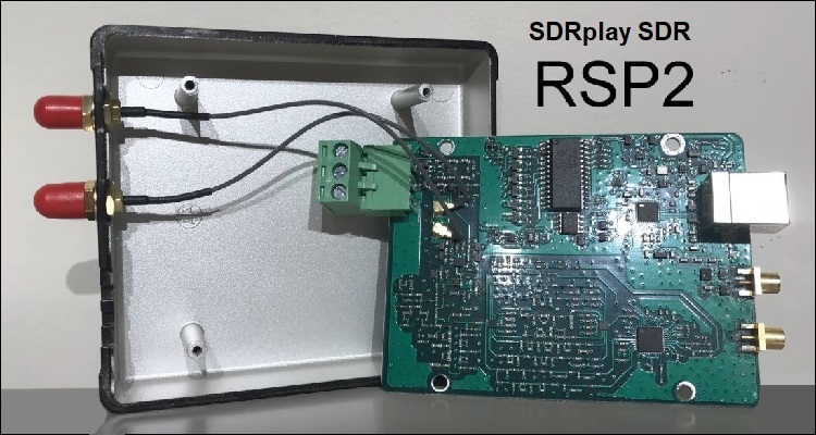

Then I decided to just wrap the plastic SDR enclosure in foil and turn On the Clock spur removal
CONCLUSIONS:
It is important to properly set the Reference level to display the correct SNR.
The RSP1A has a plastic enclosure that is letting strong signals through. I had hoped that the inside of the plastic enclosure had been sprayed with a conductive paint that would act like a shield, but apparently that wasn't done.
The aluminum foil that I put on the outside of the enclosure, and contacting the ground of the SMA antenna input connector, acted as a substitute shield.
The RSP2 looks like it has a conductive coating inside:

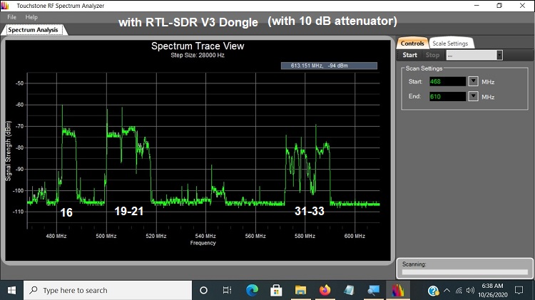

The resolution isn't too good and there is no way to adjust the gain of the dongle. It is necessary to insert an attenuator before the dongle to obtain the correct representation of SNR.
But, the Touchstone software does cover more than one channel and you can see changes in real time. With the RTLSDR Scanner, you don't see the scan until it is completed.
The amount of attenuation must be found by trial-and-error. It helps if you have a TV that will tell you the SNR of a known signal.
The Toner attenuator shown above could be used.

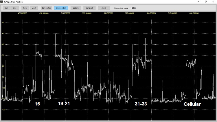

But, I think it would be better to buy an SDRplay RSP1A and use the RSP Spectrum Analyser software.
When I used the 17 dB preamp with the SDRplay RSP1A and the RSP Spectrum Analyser software, I was able to adjust the Display Scale settings for a proper display:
The ADC is the Analog to Digital Converter in the SDR.
The channel 16 signal input to the RSP1A with the 17 dB preamp measured -35 dBm. I don't usually use the preamp; just wanted to see how the RSP Spectrum Analyser software would handle the stronger signal.

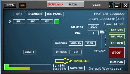

When the RSP1A is used with the SDRuno software, there is an overload warning if the gain is set too high. It did flash when the gain was set to MAX when using the 17 dB preamp. To avoid damage to the RSP1A, the input signal should be kept below 0 dBm (49 dBmV).

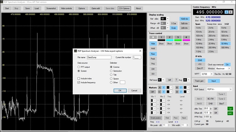

The only software that I know of that will produce CSV output is for the RF Explorer SA and the V1.1 RSP Spectrum Analyser for the SDRplay RSP1A:
Interesting, thanks for the info and images.

However, also would like to log and export data.
The specific high dynamic range application does not necessarily require logging, and the logging application does not necessarily require high dynamic range.
Therefore, an option could be to use Airspy R2 for high dynamic range tests and the low cost SDR dongle with RTLSDR Scanner software for logging.

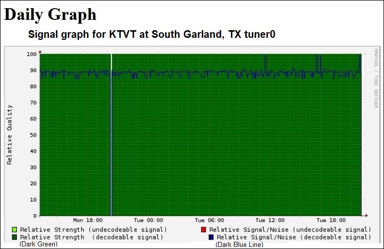

Yes, thanks for your thoughts on this topic, that approach could be quite helpful.
Having capability for logging signal quality over longer periods of time (at least 24 hours) would help in evaluating the performance hardware design changes.
Think most contributors to RabbitEars Bandscan use SiliconDust HDHomeRun tuners.
Recently purchased one of those tuners for the purpose of recording signal strength and signal quality.
According to Trip at RabbitEars, seems the software that produces the web display is not set up to export raw data to a file format that could be conveniently imported to Excel.
A person who developed a Windows version of that software said it would take some time, but he could add the option to make the export.
Old 25-Nov-2020, 2:02 PM   #75

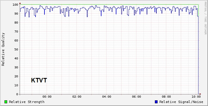

That is true. Here are Trip's instructions for setup:
Joining the Live Bandscan
https://www.rabbitears.info/static.p..._live_bandscan
It is possible to modify the graph for clarity:
File Type: jpg tripelo-Signal graph for KTVT modified_1.jpg (115.7 KB, 7973 views)

It is possible to modify the graph for clarity:...
Yes, in many cases, the graphical images could be helpful.
Having the raw data to analyze, when looking for relatively small performance differences (say between two different antenna preamp combinations), could help to ascertain differences of less than one dB.

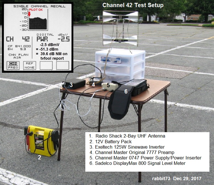

That would be good if was practical. For accuracy, the two antennas would need to be located at the same physical place. In many cases at UHF, a separation of a foot or so, and the two antenna combos can receive different signals.
That is true because the wavefront is non-uniform. I have seen a difference in the scan of a channel when moving the antenna a foot horizontally.
But then, how is it possible for you to make a valid comparison of the performance of the two systems? Have the two antennas on a sliding carriage that moves each antenna into the same location, or what? Otherwise, how can you possibly get a comparison like you would on a lab grade antenna range? On a range, you would use a constant strength test signal and place each antenna, in turn, in the same location.
The closest I got to the ideal was to switch the two antenna locations, but I really wanted to be able to slide them sideways.
The white wall was just a background for the photo. The actual comparison was done at a location with OTA signals that were as constant as I could find. I used an A/B switch for a rapid comparison.
