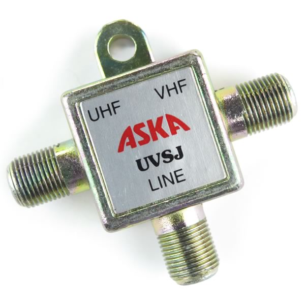

Is a UVSJ combiner something that looks like a splitter but not a splitter?
If so I have one, maybe, that I have been using
A UVSJ physically looks live a splitter but works very differently. It has an input marked UHF, another input marked VHF and a Line output. I would not count on it being a UVSJ unless it is specifically marked as such.
The UVSJ has a very specific function and is used when you want to combine UHF signals from one antenna with VHF signals from another antenna.
A UHF antenna will receive some VHF signal. The UVSJ filters out the VHF component from the UHF antenna.
A VHF antenna will receive some UHF signal. The UVSJ filters out the UHF component from the VHF antenna.
Since you have signals being received on two antennas, the signals may arrive at each antenna at a slightly different time. When combined together they may offset each other and lessen the total amount of signal making it weaker. Using the UVSJ, when it combines the signals from the two antennas, there are no competing signals that will mix with each other and cause signal degradation.

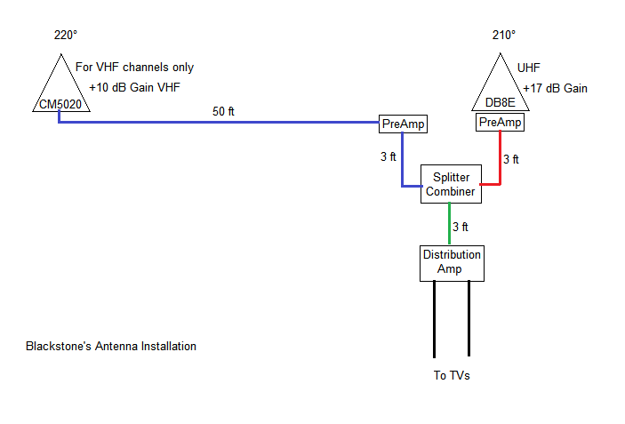

After rereading this thread from start to finish, this is what I gather about Blackstone's situation:
He has a DB8E pointed 210 degrees to receive UHF stations only. It has a preamp.
He has a CM5020 pointed 220 degrees to receive VHF stations only. It has a preamp.
He has a separate feed from each antenna going to a Channelplus combiner/splitter.
The output of the combiner/splitter goes to a Channelmaster amp and out to the TV sets.
Blackstone, can you confirm that is how you have your system set up? If not, can you describe further?
Last edited by Tim; 14-Apr-2019 at 7:20 PM. Reason: Revised based on Blackstone's comments

Tim, you have it almost totally correct.
The only thing different is that both antennas are aimed at, essentially, the same direction.
The DB 8E is, roughly 210-215 and the CM is, roughly, 220-225.
It may not be germane but each line has it's own preamp

Are the preamps mounted at the antennas?
Approximately how much feedline from the antenna to the preamp?
Approximately how much feedline from the preamp to the splitter/combiner?
Approximately how much feedline from the splitter/combiner to the distribution amp?
Old 14-Apr-2019, 7:51 PM   #52
blackstone
Join Date: May 2017
Posts: 139
One preamp is at the antenna for the DB 8E and there is approx. 3' from the antenna to the combiner.
The other is inside for the CM.
There is a 50' cable to the preamp and 3' to the combiner.
I think there is a 3' cable from the combiner to the distribution amp
blackstone is offline   Reply With Quote

OK, that is giving me a clearer picture of your system. Take a look at this diagram and let me know anything that needs to change.
How long is the cable run from the distribution amp to each of your TVs?
Also, are you using power inserters to power your preamps? Or are they powered directly at the preamp?

Join Date: May 2017
Posts: 139
That looks like it
Thanks, Tim
Old 14-Apr-2019, 10:52 PM   #57
blackstone
Join Date: May 2017
Posts: 139
Not 100% sure about the living room; maybe 20-25' for each.
The living room is using old Direct tv cabling
The bedroom was put in when my mom was still alive so she could watch tv in bed
Old 14-Apr-2019, 10:54 PM   #58
Tim
Join Date: Nov 2014
Location: Acworth, GA
Posts: 291
OK, good, now tell me how the pre-amps are powered. Are you using power inserters?
Old 14-Apr-2019, 10:58 PM   #59
blackstone
Join Date: May 2017
Posts: 139
I don't know what power inserters are.
If it helps, the one on the DB 8E is an Antennas Direct Pa 18 preamp and the CM is a Winegard LNA 100
Old 14-Apr-2019, 11:01 PM   #60
Tim
Join Date: Nov 2014
Posts: 291
OK, one last question, do you know the model of distribution amp?
