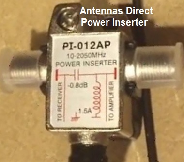

Unfortunately, I didn't take the time to check to see which channels were available after adding the pre amp. I installed the juice at the antenna using the 3ft cable that was included with the kit. I have approx. 45ft of RG6 coax running directly to my TV. I installed the inserter just before the connector on the back of my set. At the time of testing I didn't have the splitter installed. I contacted AD tech support at the time of installation and the only advise that I received at the time was to obtain an RMA and send it back. After further searching on-line I found a post at Dennys TV that recommended testing the output of the inserter with a VOM. I wish I would have ran into that post before I sent it back. The post went on to say that the inserter uses the braided shield as a ground for the 12 VDC power supply. It is possible that the braid isn't terminated properly on one end or the other. I will definitely check that possibility before I try this again.

As a shortcut in checking continuity of a coax, simply go to one end and jumper the stinger to the shield, then go back to the other end and verify continuity from that end, should be near zero ohms. Remove the short and verify the meter reads an open circuit.
Old 23-Feb-2016, 5:40 PM   #47
ADTech has given you good advice on checking the coax between the preamp and the power inserter using an ohmmeter with no power connected. You can also check the voltages, being careful not to short the center conductor of the coax to its shield.
This troubleshooting method is for a CM preamp, but is similar to what you need to do with the Juice.
