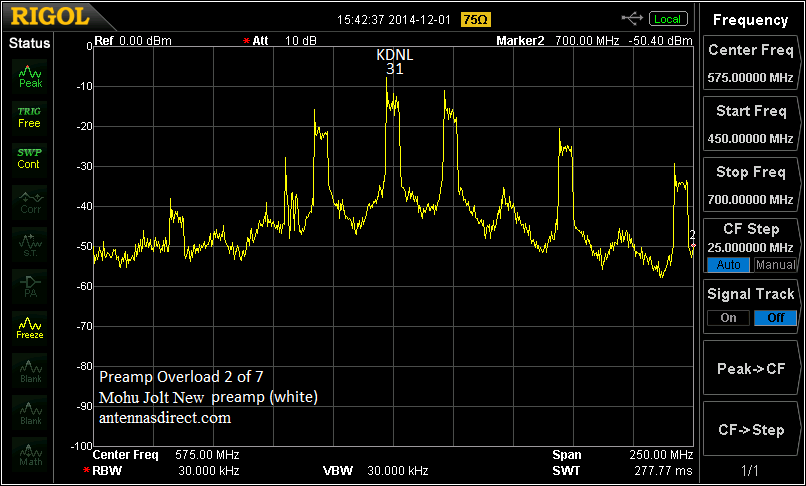

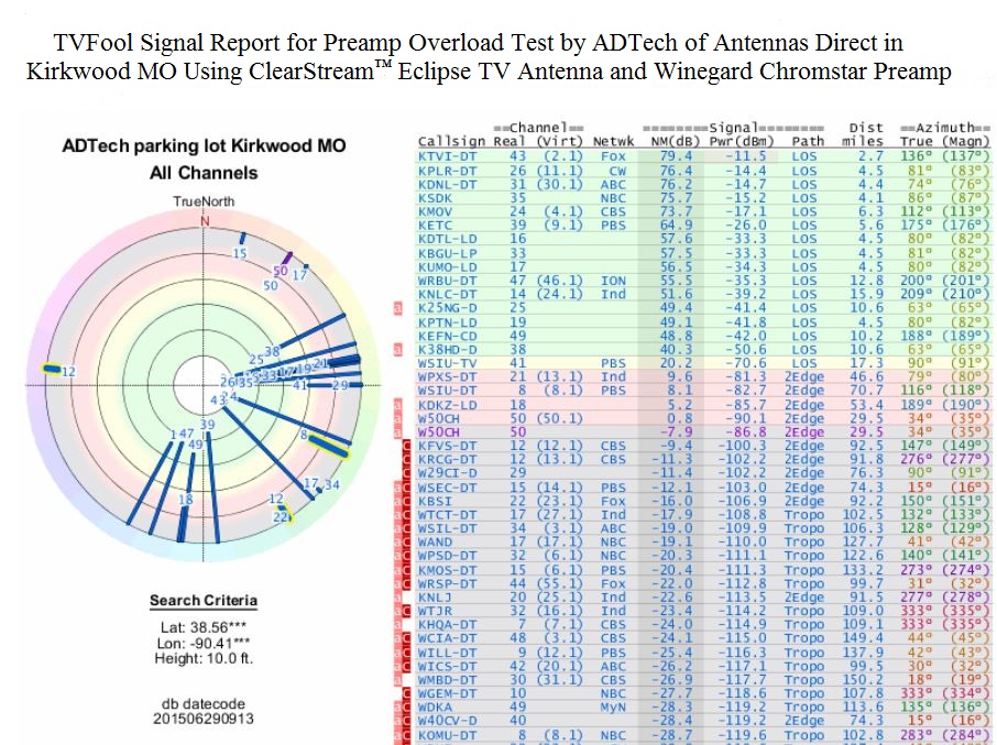

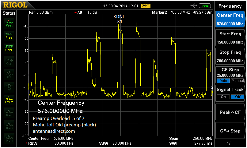

ADTech did some interesting tests that show how weak signals are damaged when a preamp is overloaded by strong signals:
Just the antenna, no preamp:
This is what the same signals look like when the preamp is moderately overloaded. Notice that the weakest signals are damaged first. The noise floor rises from the spurious signals created by the IMD. This reduces the SNR of the weak signals to less than the required 15 dB minimum:
This is what the same signals look like with a badly overloaded preamp:
This is what the same signals look like with a high quality preamp that isn't easily overloaded:

Almost like audio amplifiers producing harmonics when clipped.
Yes, exactly. Clipping produces harmonic distortion products. Intermodulation distortion produces spurious signal products.

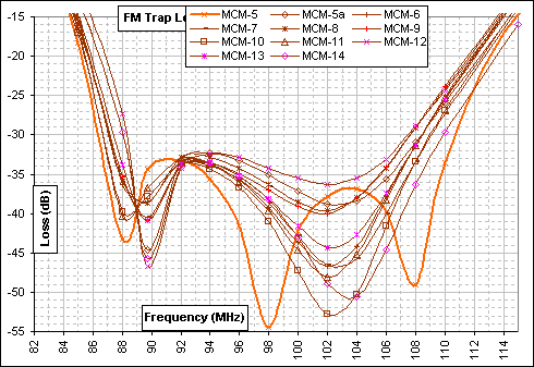

Are the Antennas Direct FM traps good for the job?
They are good, but you have to look at the strongest FM signals to pick the best filter. The AD filter does a good job at the 88 MHz end of the FM band, but is a little lacking at the 108 MHz end. The Radio Shack filter does a good job at the 108 MHz end but doesn't attenuate well at the 88 MHz end to allow reception of TV channel 6. The MCM filter does well at both ends.
CJFIFM 99.9 MHz -14.4 dBm
CHKS-FM 106.3 MHz -22.1 dBm
CBEGFM 90.3 MHz -27.2 dBm
WSAQ 107.1 MHz -29.2 dBm
http://www.mcmelectronics.com/produc...800829%2Cd.eXY

Alright, I ordered 4 of the MCM ones. I guess i may as well work on some of the other stuff while i wait. Mainly grounding since I already have the guy wires installed.
