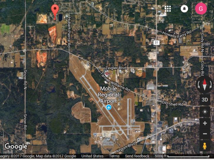

There is a large water tower and an airport near by.
It looks like you were in the flight path:

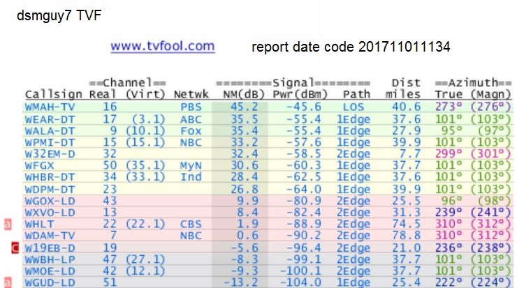

Thank you for the signal report. The latest TVFool database, date code 201711011344, has some channels missing, and other errors:

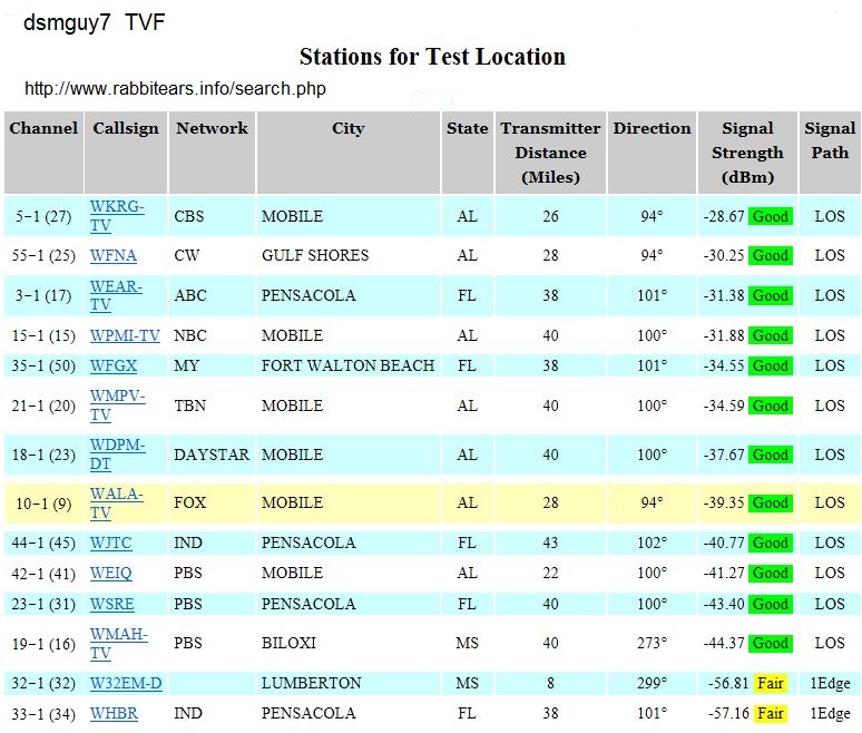

This is a report from RabbitEars.info:

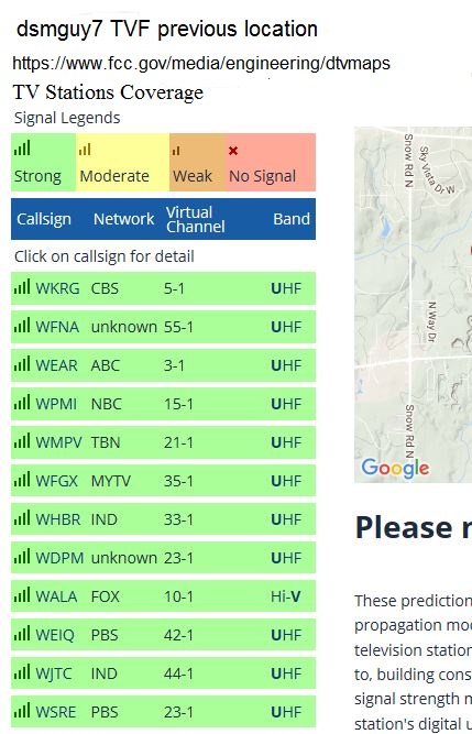

This is from the FCC DTV Reception Maps site:

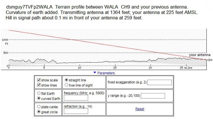

A first glance at your signal report would seem to indicate that the RCA ANT751 would have been sufficient for WALA if a preamp had been used. But closer examination would show:
1. There were objects in the signal path; the report assumes the antenna is in the clear
2. The antenna doesn't have as much gain for VHF-High channel 9 as it has for UHF channels. An antenna with more VHF-High gain was needed
3. The hill in front of the antenna was blocking the direct signal
Tower Guy gave you good advice. He is a TV station engineer, but you didn't know that then.

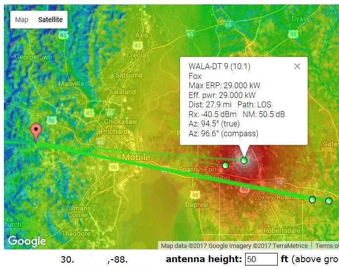

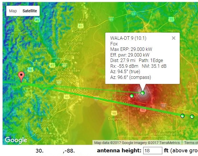

When the signal is skimming the terrain surface, small changes in antenna height can make a dramatic change in the signal strength.

Wow. So 7 more feet and a preamp or the larger antenna and a preamp and I would have been ok.

Well, maybe. The computer simulation is only accurate to about a football field size as far as location is concerned. The apparent accuracy is greater than the actual accuracy. It's still trial-and-error, because there will be hot spots and cold spots at a location when the signals are diffracted by terrain obstacles.
