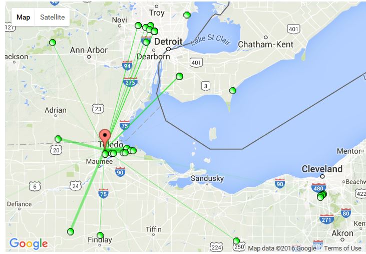

Old 4-Mar-2016, 2:46 PM   #30
Originally Posted by Blackbeen View Post
I got an ad Solid Signal for the Televes DigiNova Boss, seemed kinda interesting as a possible quick fix, I have a J-mount outside the northbound window of my 3rd floor apt that I used to use with the DB4e antenna before I chimney mounted it, its rather expensive though given I plan on doing it up right with a Winegard HD8200U on a 50' tower when I move into a house, but I'm really missing my Detroit channels.
That antenna is presently on sale, but whether it would help with your Detroit channels is unknown. Any preamp needed for Detroit signals would probably be overloaded by your strong local signals.
Here is an active link for your tvfool report:
http://www.tvfool.com/?option=com_wr...513435d523b966

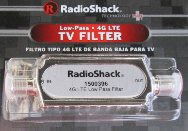

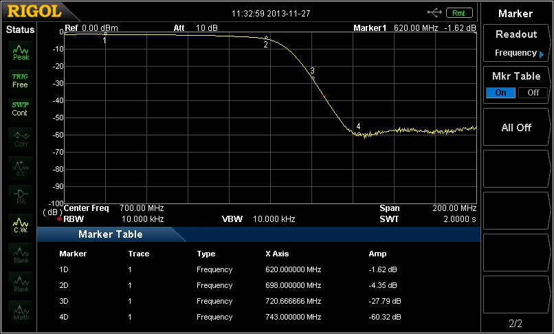

I like option 3 also; it would give you a chance to try SOMETHING to satisfy your curiosity without being reminded of the incompetent installer, or putting you at greater physical risk.
I also forgot to add, there is a cell phone tower very close to the Detroit point so I'm curious if this LTE Filter might improve reception I wasn't at all aware of cell tower interference prior to reading about this filter.
This will become a more common problem as the cell transmitters move into the frequencies previously used by the TV transmitters above CH51 and given to commercial interests by the FCC.
https://en.wikipedia.org/wiki/Cellular_frequencies
This has become a problem in England; you will see filters available there, but they are rare here. Antennas Direct is a harbinger; they added the LTE filter to the Juice, but didn't have enough room left in the housing to also include an FM filter.
The attachment has the curve of the Radio Shack LTE filter that was done by ADTech IIRC.
http://forums.wtfda.org/showthread.p...-thru-61-issue

The Juice never had an FM filter. Also, the latest version of the Juice's filter is now a "cellular filter", it cuts in later than did the ones in the first production run as they cut in a bit too early and there was some affect on the upper UHF channels. The filter is no longer mentioned in the marketing, it will disappear from the packaging the next production run.
FWIW, I've yet to personally see a single instance of reception issues specifically attributable to cell and 4G service. I suspect the UK folks are being might conservative.
Also, the filtering in the Televes is going to be relatively useless for North American systems, it was designed and manufactured for the Euro market.
The RS filter is NLA although you might fined it on ebay or in-store on closeout.
