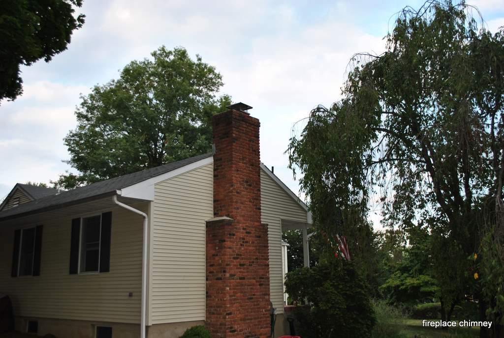

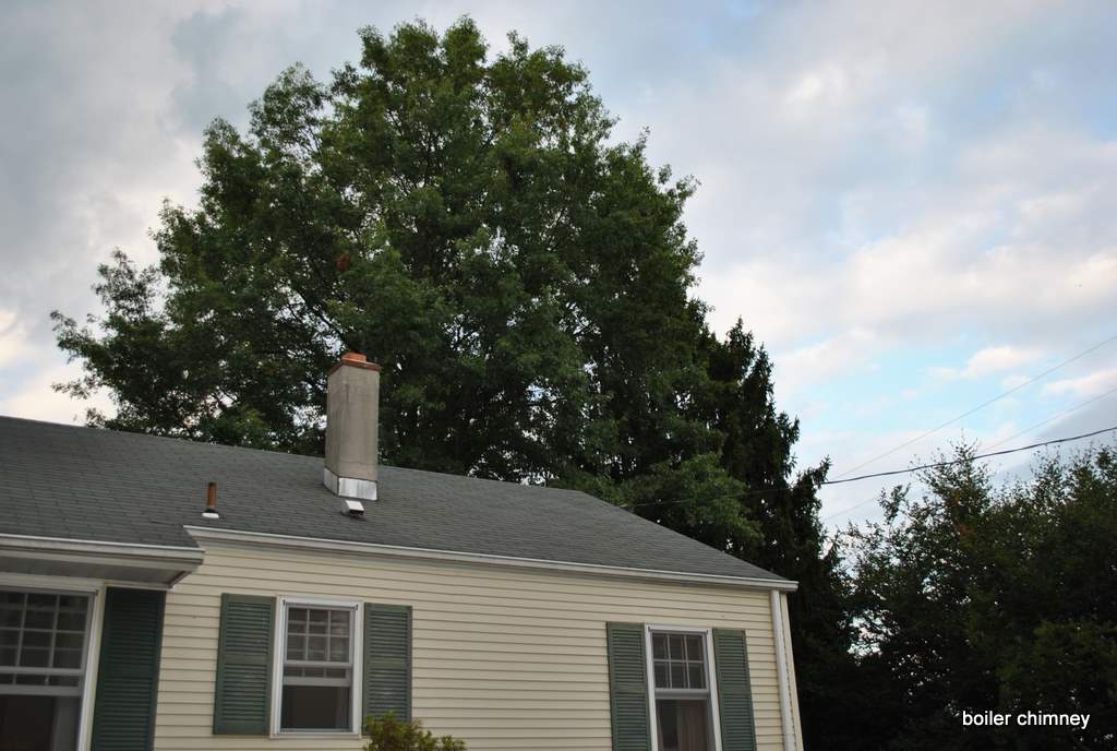

place to mount...
Thanks for all your help guys - been scouting the outside of the house for a place to mount the antenna - I think one of 2 chimneys is best -
One chimney (smaller white one for boiler) is closer to the pine tree in the direction of the tower and the fireplace chimney (brick, bigger) is further back from the tree.
I'm thinking the further back from the tree the better - the only thing with the fireplace chimney is that it has a metal cap - will this impact my signal, with say a 5 ft mast?
Thanks.

The brick chiminey is the winner to mount, the cap should not hurt you at 5 feet up, and the trees don't look like they'll be an issue either. I'd bite the bullet, get a vhf/uhf antenna, mount it and see what you get.....

cool, thanks, was leaning towards the brick fireplace...
so I will need something like a 7 ft. mast to get 5 ft. above that metal cap - cause I will lose a couple of feet to mounting eh?

Just buy a ten foot mast and cut it down to the right size. If the local hardware store can't do it then a hack saw should work. Lowes cut a 10 foot piece of EMT for me. May want to look there.

....or two 5 footers, this way, attach one 5'er to the chiminey, cut the other 5'er to length, attach antenna and coax to that one laying on the roof, then slide that mast onto the chiminey mast...easier and safer...
