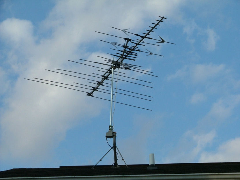

Just one more question. I've attached a couple of pictures of the new antenna and rotor. The mast is and inch and half 5'. The Rotor is sitting on the J-mount (which had a level sight glass in the top of it). I didn't feel top heavy but, IMO, it 'looks' top heavy. Should I be concerned?
In my opinion, the J-mount is not sufficient for the weight/windload of the installation. A tripod with thicker legs will be needed & the lag screws need to be anchored through rafters or with some type of re-inforcement inside the attic. I've done a tripod mount before, but since I used guy wires, I just ran the lag screws through the roofs plywood under the shingles. I'm sure others here will be more knowledgeable with how much support a non guyed installation will require.
I would certainly address this soon as a strong cold front with high winds is due here late Sunday night.

I recommend lowering the HD7084P antenna on the mast so as to reduce the side ways leverage twisting in the rotating part of the rotator. A better way to do it is to have the mast that the body of the rotator is clamped to , longer and the mast that the antenna is clamped to shorter. The j mount with the brace rods will be a good strong setup if screwed/bolted in to the roof good and strong.

Thanks for the opinion, NSAA. I didn't count all of the costs to include in this project and I didn't order a tripod. I wanted to spend as little as possible and ended up ordering an antenna that I have to return. Do you think that a 5' tripod would do the job without g.wires?
If I do use guy wires, do they make a special clamp that I could use to attach the guy wires to the upper mast or are U-bolts suitable? I would really like to find a clamp that provides an "eye" for the wires at the mast end.

The braced J-pole is far better than one without bracing.
5' tripods are very strong and make a premium quality foundation for virtually all OTA TV antennas.
If you have access to the attic, blocking between rafters can be added after drilling through the roof deck (it's easy to locate the blocking precisely once to hole has been drilled). Construction grade screws through the rafters into each end of the blocking will transfer load to the rafters. With bolts through each tripod foot, through the roof and deck materials and through the blocking, you'll achieve a very strong anchorage with little chance of fasteners pulling out under stress. Use pitch pads and roofing sealant (of course).

I have searched for a couple of hours with no luck to find a guy wire ring/clamp that would allow the mast to turn inside the ring when the rotor turns. I am not going with a tripod mount bc I have a metal ridge vent on the roof and I'm still set on using my supported J-mount as the base mount. I was going to post this elsewhere in the forum but, can't find the right sub-forum to start a thread regarding this issue. Can anyone suggest an arrangement that may work for me, using the current base mount and rotor arrangement?

Lowered the the antenna on the mast until the weather breaks. Bought some galvanized pipe (much thicker wall. There won't be any sway with these as masts.), today and had it cut to lengths of 2.5 feet each. I'll move the rotor up and secure the antenna to the upper 2.5 when weather permits. Lowering it, today, did not affect the reception. Waiting for a little warmer, less breezy weather.

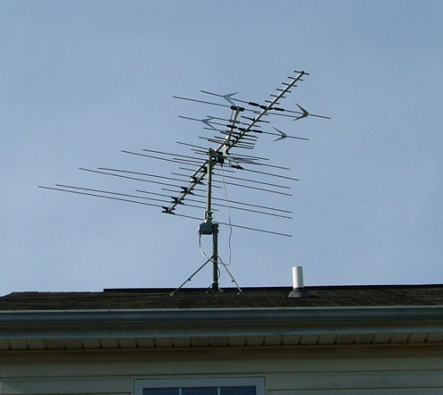

Final Setup Until Spring Arrives
I finally removed the 5' mast and installed a 2.5' mast that is 1.5" galvanized pipe. It is much heavier and more rigid than "antenna mast" material and I have adequate reception at this height.
I've attached a picture of what I have, now. In the Spring, I'll bring the cable into the attack and attach it to coax that runs down the far corner of the house and into the basement where my splitters are located so that I can supply my other rooms.
It is great to receive all of the digital and HD stations out of Philly, crystal-clear and without breakup. Now, for the first time in a long time, I am enjoying HD, FREE! Well...minus the things that I have purchased to make this plan come true.
Thanks to all who assisted. Pointed at 65-70 degrees (Where is the degree sign on my keyboard?), I'm getting all of Philly's transmissions.
I have rotated to 230-235 degrees and receive three or four Baltimore stations, as well.
