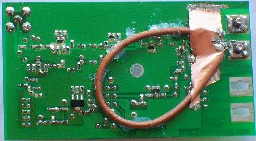

Image of CM0064 with half-wave balun below:
The coax is RG-180 (95 Ohm). The impedance is not ideal, but in some ways better than 75 Ohm coax.
It could be better if the impedance for the loop was 150 Ohms.
But, such cable would have to be custom made and it would probably be too large to fit in the case.

Based on the circuit design, the components, and comparative testing:
The older 0064/0264 have about the same noise figure as the BT Galaxy series.

The Twinax is shielded twinlead. Like your 300 Ohm twinlead with a shield. It could be useful in some situations.
It probably could be made to work for a half wave loop balun. but would require some unconventional considerations.
In general, coax is better for the half wave loop.
Referring to the 0064 with half-wave balun in previous image.
The input & output of VHF portion was disconnected and powered down.
There is some noise figure advantage in not having a VHF circuit connected to a UHF circuit.
Anyhow, that balun would not work well for VHF.
