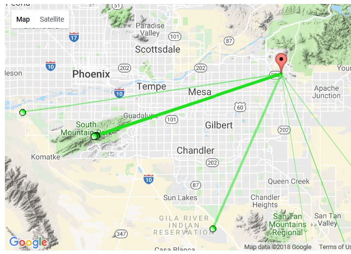

There are areas in East Mesa near Falcon Field that TV Fool indicat esare line of sight that are not. In fact, I've gotten better signals from Tucson than some of the Phoenix stations in Ftn Hills and East Mesa. I doubt the signals in your area are as strong as your report suggests. An attic antenna with a tile roof is always a disaster. Even asphalt roofs degrade the signal enough to create problems.
Based on his TVFool report, it looks like he is about 5 miles ESE of Falcon Field. He entered AL for his TVFool report instead of AZ, but Google maps figured it out from the zip code, I think.

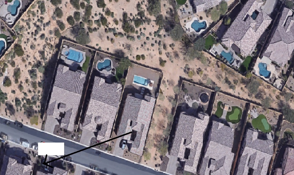

Thanks for the reply. See attached picture of the house. I pointed the arrow to the direction that the signal is coming from. There really isn't a gable vent pointing that direction and I'm not sure what type of material was used for insulation. We close on the house in August, but it's exciting to live in a place that actually has TV reception that doesn't require a 50 ft pole.

I finally moved into the house and started doing some testing. I purchased this simple small antenna just to see if I can pick up any channels: https://www.amazon.com/Newest-Amplif...dp/B07B1VKXJD/
I actually picked up 48 channels after doing a scan with my TV. I put the antenna by a window, which is facing opposite direction of where the TV stations are. Most of the channels were SD. Either it was able to go all the way through the house and pick up the channels or it picked it up from the window which isnt facing the stations.
See picture with red X where I placed the antenna.
