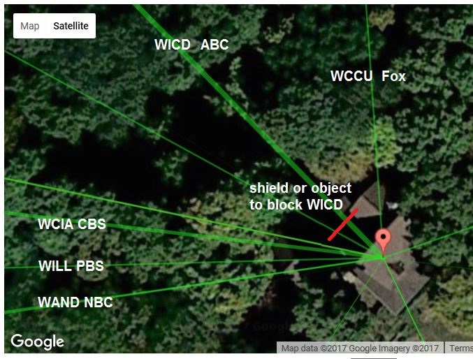

Thanks for all the replies, just getting back to this. Rabbit73 how big a shield of aluminum foil and cardboard? Where in relation to the attic antenna do I put it to block out WICD 41? I will try to post pics of the outdoor antenna tonight. Thanks!!
For best reception of WCCU, the antenna should be aimed at WCCU. The cardboard covered with aluminum foil should be at least as large as the antenna and fairly close to the antenna to block WICD. The cardboard should be on the WICD side of the antenna.

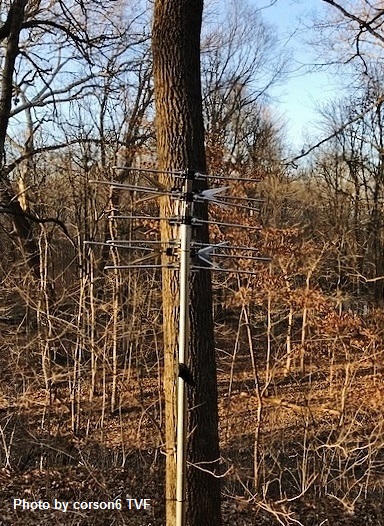

Here is a pic of my outside antenna. The WICD 41 tower is BEHIND the tree. So far it's just been a either/or experiment. I don't really know what kind of antenna that is in the attic (or exactly how to shield it with foil and cardboard from WAND 41) Again I would really like to be able to get WCCU DT 27.1 When the interference happens, I see little color squares popping up over the top of the old B&W re-runs I like, so does this mean WICD 41 is trying to come in over the top of WCCU? Thanks again for all the help!
Thank you for the photo of your outside antenna; it looks like a Winegard HD-1080.
For best reception of WCCU, the antenna should be aimed at WCCU. The tree is not big enough to block the WICD signal.
Yes, WICD is so strong it is damaging the WCCU signal which increases the errors in the WCCU signal and results in pixelation.
The Winegard HD-1080 antenna isn't very directionaj. For best reception of WCCU the antenna needs to be more directional so that it will reject the WICD signal. If that isn't enough, a shield would need to be placed between the antenna and the WICD signal. For an outside antenna, the shield can be a wire mesh screen or a building that blocks the WICD signal, but doesn't block the WCCU signal.
The coax must be grounded with a grounding block connected to the house electrical system ground to reject interference from WICD.
If even that isn't enough, you will need a custom channel 41 bandstop filter to make the WICD signal weaker. If that works, you will need another custom filter when WICD moves to channel 32:

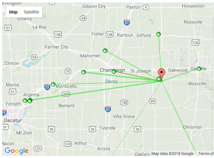

Your antenna is very directional. When it is aimed at WCCU, it doesn't pick up WAND and WBUI very well because they are in a different direction. That is why it is difficult to pick up everything you want with just one antenna.

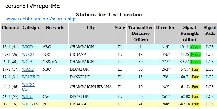

This signal report from rabbitears.info shows the channels you want:
Originally Posted by corson6 View Post
So, looks like I need a second antenna to go with the attic one?
It does look like you will need two antennas to get everything you want. The attic antenna is for UHF and VHF, but since it seems to be doing well for WCCU Fox, I would use it just for Fox.
Should it go in the attic also?
Your second antenna, for the signals from the west, can be inside or outside; you will need to do some more experiments.
I could use the Winegard that's out in my yard, or there's a open box deal on a C2V at Best Buy for $35.
Neither one of those antennas is suitable for the signals from the west, because they don't have enough gain for WILL PBS on VHF-High channel 9. You need a UHF/VHF combo antenna like the Winegard HD7694P for the channels from the west.

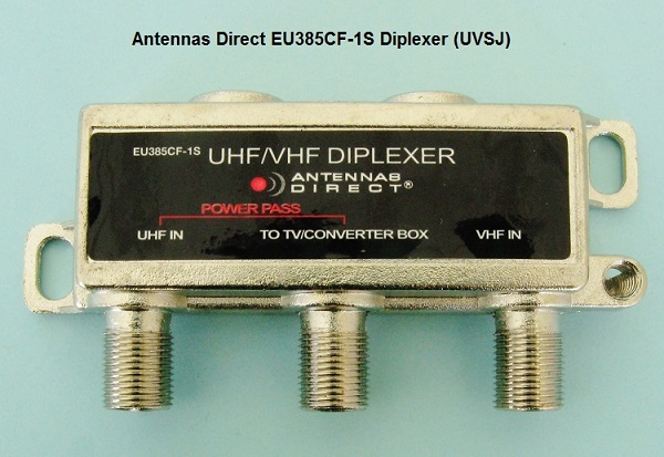

Or does it need to be a "combiner"? The UVSJ has been mentioned, but when I google it I'm not finding one.
The UVSJ (UHF-VHF-Separator-Joiner) is a type of combiner; it combines a UHF antenna with a VHF antenna, but not two antennas that both receive UHF signals. In your case, for example, if you only wanted to receive just Fox 26 and PBS 9, you could use a UVSJ to combine a UHF and a VHF antenna that are aimed in different directions.

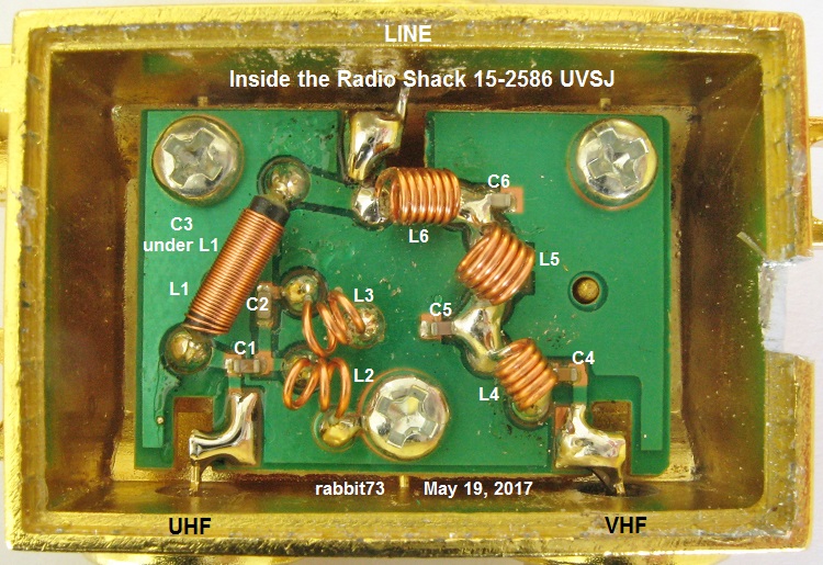

UVSJs (AKA UHF/VHF Diplexer) are getting hard to find. This is what they look like:
https://www.antennasdirect.com/store...Combiners.html
https://www.antennasdirect.com/cmss_...blyInstall.pdf
https://www.radioshack.com/products/...itter-combiner
I'm concerned once I start adding TVs I'm going to have trouble, and the consensus seems to be NO AMP because of WICD being so close. This has been challenging but I'm making good progress. Thanks again for all your help!
Based on your signal report, the consensus is that a preamp should not be used because WICD is extremely strong. But, the actual WICD signal at your location might be a lot weaker because trees block TV signals (the report doesn't know about the trees), and since you are so close to the WICD tower, the strongest part of the signal beam might be well above your location. Also, since neither antenna will be aimed at WICD, that will make it weaker.
If you had a signal level meter, you could measure the strength of the signals, but you might have a TV with a relative signal strength indicator in the menu. With it, you could find out just how weak a signal can be and still be received.
With the proper antennas, aimed in the correct direction, WCCU and the signals from the west should be strong enough. Once you have each antenna able to pick up the channels you want, then we can talk about the combining options. If the signals are still too weak after splitting, then a distribution amp can be added before the splitter.

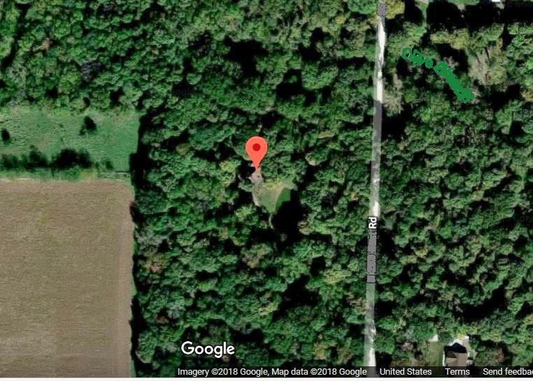

Trees block TV signals, especially when they are wet.
Scroll down to Trees and UHF if the hdtvprimer.com site is up.

As a substitute, you can insert a UVSJ, UHF and common ports, which will pass only UHF signals and block VHF and FM.
