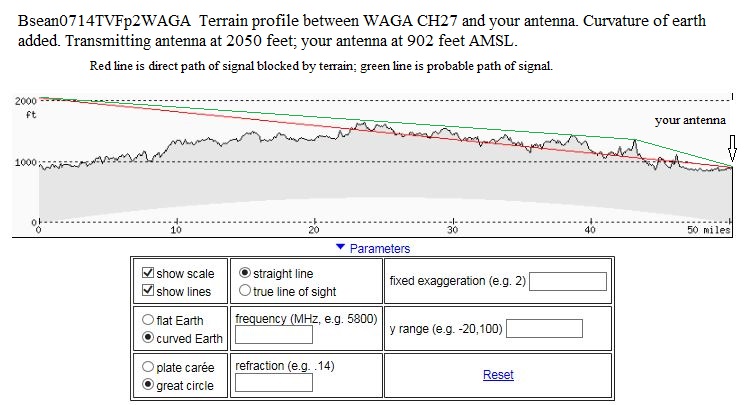

You're not getting the FOX station because you managed to plop the antenna down in a "dead spot" for that station's signal.
The LNA200 is not comparable to the Juice. You're welcome to try it, if you wish.
Old 11-Jul-2017, 5:53 PM   #40
You need to follow ADTech's advice in post #33 to even have a chance for Fox.
The WAGA signal is obstructed by terrain; it needs all the help it can get.
