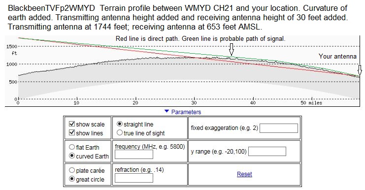

at this point I have [to] conclude that the loss of DB4e from the stack or the combiner are the cause

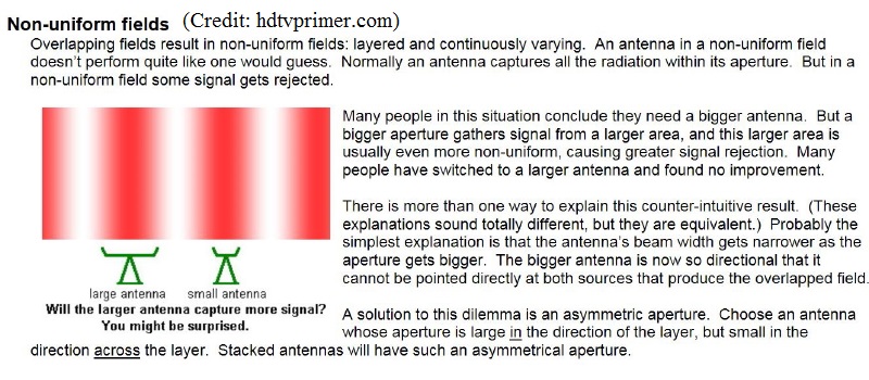

That got me wondering about the UHF antenna change. It wouldn't be gain, so maybe it is a slight change of antenna location or the form factor of the antenna.
I did a terrain profile that shows how the curvature of the earth blocks the direct signal and causes it to graze the surface and be subjected to ground clutter interference.
The ground clutter interference will cause scattering of the signal so that it presents a non-uniform wave front to the antenna. This non-uniform field makes the location of the antenna very critical, because there will be hot spots and cold spots.
It is also possible to have a non-uniform field in the vertical direction. Moving a UHF antenna a little as 6 inches up or down can make a difference. That would be easier for you to do than moving it in a horizontal direction. I wonder how the DB4e would do now?
File Type: jpg Non-uniform fields HDTVPRIMER snip2_1.jpg (142.5 KB, 4884 views)

Great explanation of multipath by Rabbit, who else?
Rabbit,
I have to hand it to you, that was the best explanation I've ever seen of multi path. I for one didn't get it to be honest. I think I'm getting the hang of what multipath means now.
Using those illustrations sealed the deal for me. Is Ken Nist still active?
