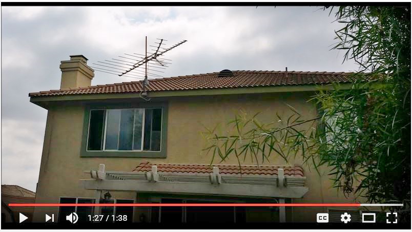

Which way is the antenna aimed in the photo?
Is it aimed at the solar panels?
(This is something new AFTER I relocated the antenna from the ride corner of the roof to the left side. The reason I relocated it was because after my neighbor recently made an addition to his house, I noticed I got weaker TV signals. Maybe his new roof was reflecting the signals away from my antenna..?)
Does the photo show the new location?
Is the left side on the NW or SE? Maybe you could send me a satellite image of the antenna location in a PM, or I could send you an image with my guess marked.
Does the corner point to the east?

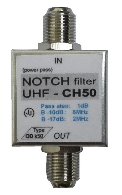

If you want to experiment, you can try a notch filter that removes 24-29.
ChannelPlus ModelNF-471 Notch Filter
https://www.amazon.com/Linear-NF-471.../dp/B000J3AEYA
The Jan Jenca ch26 filter would probably be about the same price, but is a custom order from Slovakia.

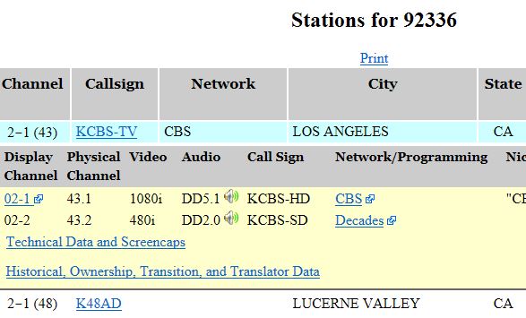

I don't think there is a list that gives real channel, virtual channel and frequency of real channel. If you know the real channel number, then you can look up the frequency of that channel in the link that I gave in post #28.
by zip code
click on callsign to see subchannels
The display channel is the same as the virtual channel; the physical channel is the same as the real channel.
You can do it here:
http://www.rabbitears.info/search.php
If you enter just the zip code, the distance and direction will be off. If you add your street address, it will be more accurate. If you also check Strength Search (optional), it will generate a report similar to a tvfool report. I will not give a link to that result because it will show your street address.
Why do you need to know the actual frequency of the channel?
The only time I need it is to design an antenna for a certain channel, to calculate the specs for an interference filter, or to know if the second harmonic of an FM transmitter falls on a VHF-High channel.

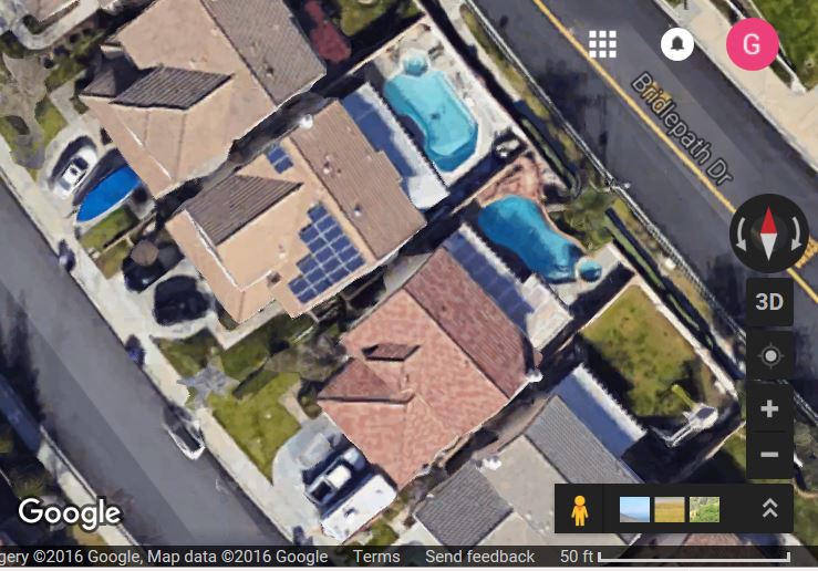

Solar Panels?
Hi again:
Well, I haven't been able to swap everything out yet because I'm waiting for WM and HD orders to arrive... (18 ga pole, dielectric jelly, more coax connectors, etc...)
On another reply you spoke of Solar Panels possibly interfering with the OTA signals.
It just so happens that my other neighbor, 2 doors down behind us, has panels and this is directly where I am pointing my antenna towards Mt. Wilson ( ~280 degrees west)
(see attached pic)
https://drive.google.com/open?id=0B6...VF0UXNROHlodUU
I notice that signals drop on many stations late afternoon, no matter how many times I tweak my antenna, and then great signal after about a couple hours....
How likely, in your opinion, would solar panels be the culprit?

Ahh, yes. I see the green signal lines pass just to the right of his panels in the photo I sent to you by PM, but I didn't want to post it on the forum without your permission.
It is possible that you might be picking up EMI from his inverters. Some inverters produce more interference than others.

I was afraid that those panels being in the line of sight for Mt. Wilson would cause some sort of interference.
On another note, I was reading some Australian TV antenna forums and discovered that the loooong elements on VHF antennas are for stations 0-5 and could possibly cause more FM and other low-band interference. Many stations here are now H-VHF and UHF, and this HD-8200XL is more of a broad spectrum design. (FM, L-VHF, H-VHF, UHF)
I was thinking of folding in the longest elements to test that theory out.
Any input on this?

Hey guys:
I did some experimenting this weekend:
I ran one coax directly from the large antenna (No splitters, pre-amps, or dist. amps) and all stations came in pretty well during the day.
I relocated the cable run from the opposite corner of eve to the closer corner of the roof eve. (Left side)
https://drive.google.com/file/d/0B6w...ew?usp=sharing
I tried bypassing the dist. amp, (Pre-amp only) but the picture was pixelating pretty bad. Without the pre-amp, the 5 TVs in the house got only a couple stations.
I re-installed the CM dist.amp and also closed/folded in the 3 longest elements and increased my KABC (177Mhz, the lowest frequency station) by about 6%. (see pic)
We also experimented by raising the antenna to the top of the pole, but it decreased the signal, so I lowered it as far as I could so it would clear the tile roof if I rotated it via the rotor motor.
I also replaced the pole with a Winegard 18 gauge steel one.
I need to remove the 2 splitters and try to combine them somehow, but the difficulty in this is that the 2 wired-in cables (Downstairs living room and master bed) are inside a TV box on the side of the house. (3 other TVs are connected to a splitter in the attic.)
Here's how it's all connected:
1. Antenna to CM pre-amp (exterior)
2. Pre-amp to CM dist. amp (attic)
3. Dist. amp to 4 port splitter (One goes to each of 3 other bedrooms.
The 4th goes to the TV box on side of house.
4. TV box connection has one 2-way splitter for both master bed and downstairs living room.
5. Coax is house grounded; pole is not grounded yet.
I'm pretty sure the coax is all dual-shielded RG6 only.
Would replacing the short coax between the antenna and pre-amp with quad shield have any significance in gain?
And do you think that a 5 port splitter would be best for our situation?
Thanks again for your expertise.
