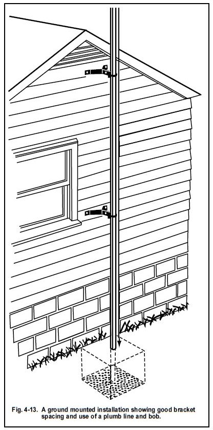

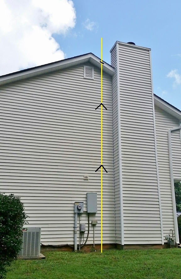

How about this?

That's what I was thinking. His house looks like new construction, the eave should be strong. As long as he can clear his utilities, it would be a clean installation.
He was talking about a brace coming from his chimney, so he could go fairly higher than the peak of the roof probably getting 35' AGL if the brace was done right.

You won't be able to run the pole all the way into the ground due to the electrical panel being directly below the ridge line.
You could however use a chimney strap mount even though that's not a brick chimney it should still work.
Edit; unless that's vinyl siding, looks like it is. Scratch the chimney strap.

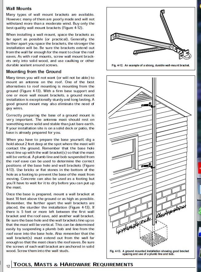

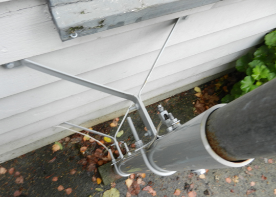

Why not use a wall mount? That's what I used for my DBGH with 3' wide screen reflector. Hasn't moved yet and it's been up there for a while now. I had to buy a set that mounted it 18" off of the wall to get around my eaves, but it's working quite well. If it's done with a wall mount, would he then be able to run the mast all the way to the ground if its moved over closer to the chimney? Or would it still be too close to the electrical meter?

That was exactly what I had in mind.
