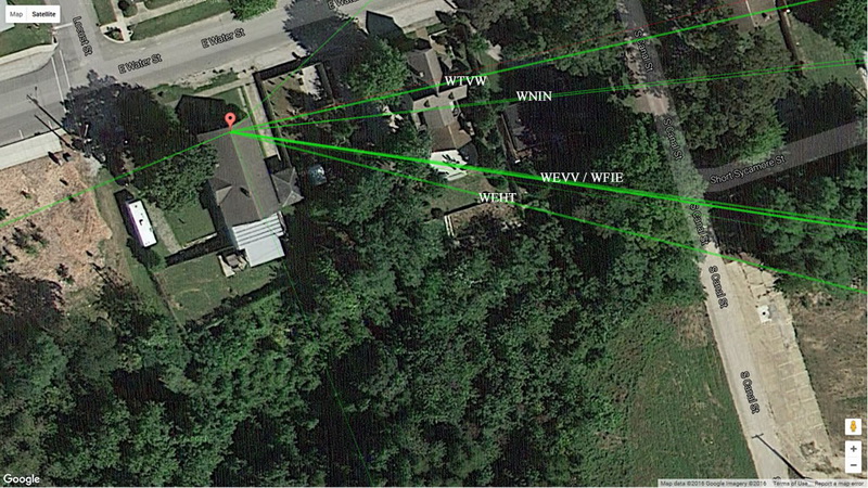

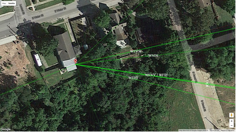

So here are the images from the interactive map showing the current location, possible chimney as well as the front of the house. All 3 show the lines indicating the path to the stations.
I still have to get on the roof to make sure I will clear the neighbors house. I have a story and a half, he has an actual 2 story house.
Current location of antenna
If I mounted on the chimney
I don't really want this location. I don't really want to see the antenna from the front like that. Beside, how to get that past the wife with a 1 year old new roof would prove difficult.

Thanks for the interesting photos. Good analysis. You do have a lot of trees in your most needed direction. I don't see an easy solution. The antenna needs to be where the signals are, and the trees will continue to grow.
An Antennas Direct C2V might look a little better from the street. I wonder if it has enough gain if you can get it high enough.
(I try to limit the width of my photos to 800 pixels. Otherwise the post gets too wide and then the type is too small.)

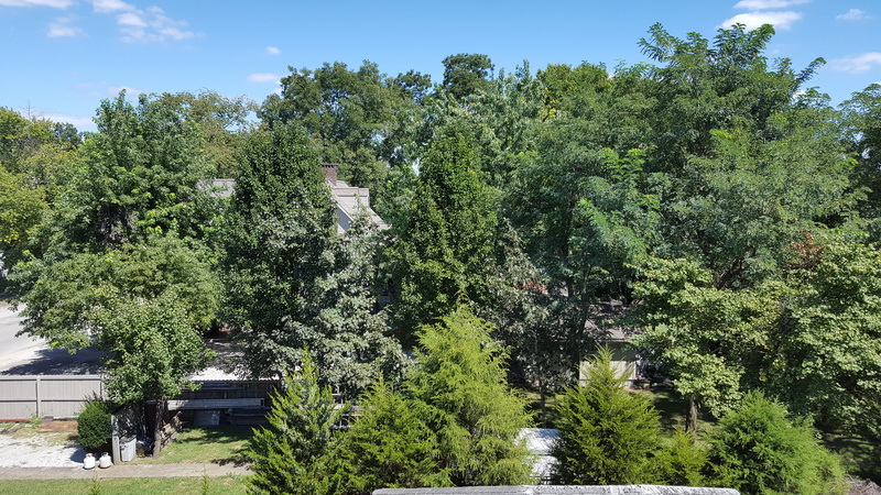

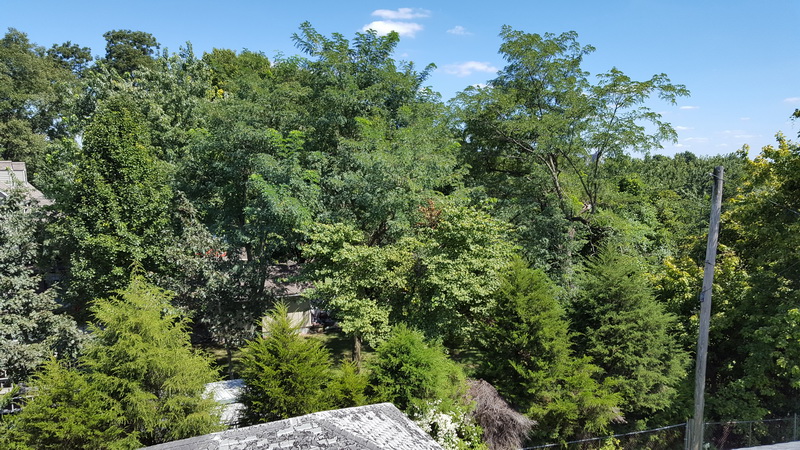

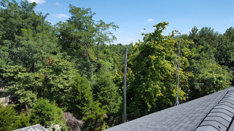

View From Roof
So I finally got on the roof today. Not one of my favorite things to do anymore. Guess I lost some nerve as I aged. Anyway, here are 3 shots from the chimney. Height is about 30 feet. I took shots in the direction of WTVW, in between where the antenna would point and finally towards WFIE, WEVV and WEHT. So basically starting West then moving right towards the South.
Looking towards WTVW
Looking towards where the antenna would point. Midway between the furthest stations.
Looking towards WFIE, WEVV and WEHT
The chimney on this old house only extends maybe 2 feet from the ridge. So the most height I could probably get is 5 foot off the ridge. So basically the height I took the pictures from.
Now comes the questions. First off I'm thinking the beamwidth of the stealthtenna I'm currently using isn't all that wide. So probably might do fine with the Winegard HD7694P at the current location. Thoughts?
My other question is about my tower. I have another 10 foot section I can add but I'm worried about needing guy wires. I currently have the tower strapped to the flat roof with 18" metal straps. THe tower is currently 4 feet above the roof. If I add another 10 foot section, would the current straps at about 15' be enough to stabilize the tower? Or should I use some guy wires?
I could easily run 2 guy wires to the east at the North and South ends of the roof. The other guy wire would have to go West and there is a utility pole there in my yard. No services on it any longer so I could anchor it there.

Thanks for the photos.
I feel the same way.
Huh? Starting East and moving South?
I think the beamwidth of the stealthtenna is at least as much as the 7694. There is an inverse relationship between gain and beamwidth. More beamwidth means less gain; more gain means less beamwidth.

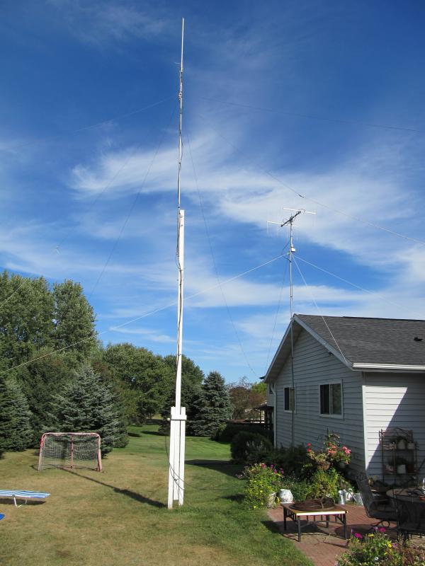

Your photos show that you must go higher. You must not extend your mast without guy wires. A good solution, to keep ahead of the tree growth, would be a 5 or 10 ft tripod at the peak installed by a roofer to reduce the chances of leaks from roof penetration by fasteners. An alternative would be a Rohn 25G tower (expensive) somewhere on your property. Another alternative would be a tilt up mast to keep you off the roof or tower.
http://wiki.radioreference.com/index.php/Tilt-Over_Mast
http://www.wv7u.com/mast/mast.html
http://freeantennas.com/tilt-over-tower/index.html
