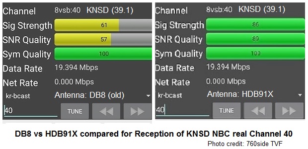

looks like the antenna did the trick

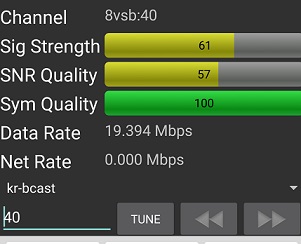

Heres my reading on knsd with the old DB8
And heres the reading after connecting the HDB91x
I didnt have any extended drops in the evening like Ive had with the DB8.
Thanks for everyones help.
Attachment 2382
Attachment 2383
Thanks for the update; sounds like a big improvement.
Did you tilt the front end of the HDB91X up?

Hi rabbit 73 It looks like the DB8 IS a dog over the H D B 91XG DO YOU THINK IT IS BECAUSE YOU CAN'T PUT A N, A G L ON IT OR IS IT JUST A DOG OVER ALL
Old 25-Oct-2016, 3:12 PM   #31
The DB8 is NOT a dog. When he bought it years ago, it was one of the best UHF antennas available.
Every reception location is different. The goal is to pick the best antenna for THAT location.
It is primarily the tilt feature of the 91XG and HDB91X that makes a difference at his location. The DB8 doesn't have a tilt adjustment; it would be a custom modification.
