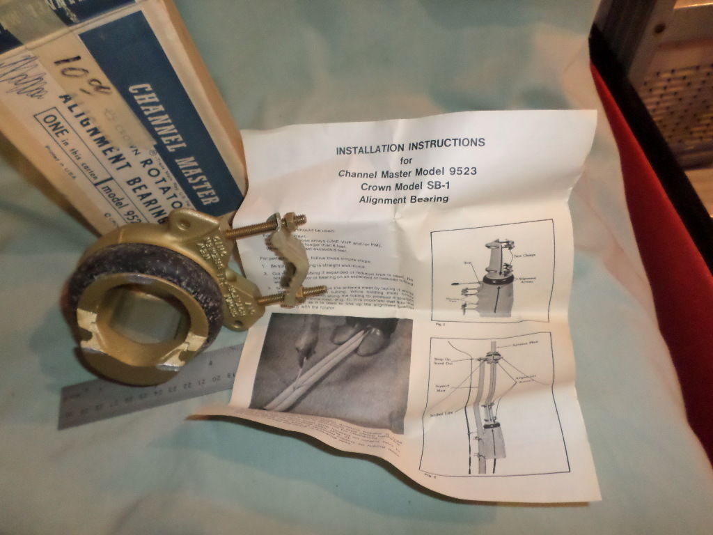

I don't think they make that bearing anymore
tazz63 is offline   Reply With Quote
Old 10-Mar-2016, 1:40 AM   #31
I think you are correct.
http://www.ebay.com/itm/CHANNEL-MAST...-/191562478065
