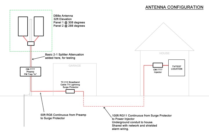

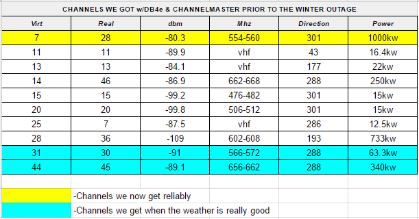

Here is the accurate TVFool report, with the adjusted 32ft elevation for the DB8e:
http://www.tvfool.com/?option=com_wr...e6a40f8dc0b42b
Here is the FMFool report:
https://drive.google.com/open?id=0By...ktwUVk5UnUzU00
My Antenna layout and setup:
Notice the panels/elements are off broadside about 10 degrees each, and should probably be closer to 15-20 each, but...
The spread for the DB8e @ 0 degrees:
The spread for the DB8e @ 15 degrees:
I have 4 cell towers within 10 miles. Number one is only 1.2 miles away, but just north of us @ 6 degrees. Numbers 2, 3, and 4 are all in the 240-280 degree range.
As we've discussed before, I've always had trouble getting what I though I should with the DB8e. Last summer I disconnected one panel on the DB8e, bypassed the combiner, and effectively made a DB4e to test. I received more channels than I ever though I could. It worked great for a while, but when the leaves fell over the winter, I lost nearly all channels.
I recently connected the DB8e back up, as I thought it should be. The setup linked above is how it's currently configured, and Channel 7(28) will occasionally show up on the TV... nothing else. Assuming overpowering, and per the recommendation of this place & ADTech, I added a splitter between the pre-amp and the DB8e, knocking the input signal an additional 3db. Here is a 24-1000Mhz RTLSDR scan from that:
So, I've effectively started over. I try to run two tests a night, lowering the tower to make tweaks. I've made scans prior to the surge protector, and although they show gains on a few channels, not enough to warrant the overall loss.
Based on the information above, what do you all think I should try next? Or, better yet, what tests would help identify the problem?
Thanks, I know there's a lot of information. I appreciate the help.

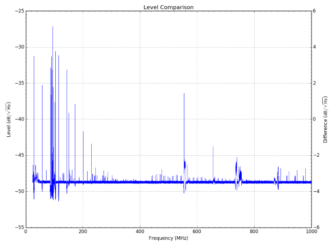

Two more scans tonite. The antenna direction and elevation did not change from the scan in my previous post above.
One, I completely removed the attenuation, preamp & injector from the mix, and took my scan at the same TV location connected straight to the RG11:
Two, I kept the attenuation, preamp & injector removed, but replaced the surge protector with a grounding block/coupling, scan completed at the TV:
The results were very close. The grounding block/coupling actually decreased the signal slightly. I'd say that's because my ground wasn't cleanly connected to the block... I noticed that after the scan.
