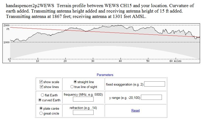

Here are the terrain profiles for WSYX and WEWS. You can see how the curvature of the earth blocks the signals. Only testing will tell you how much signal can make it over the terrain obstructions.
