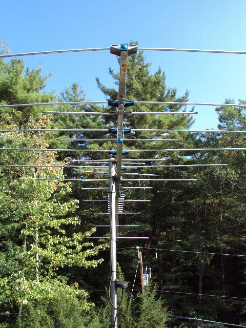

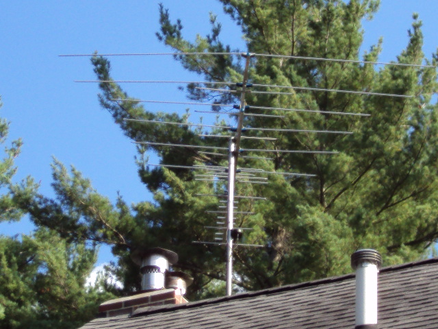

pix42 from ground
pix43 from N.E looking S.W.
pix44 holding camera as high as possible, yes the antenna is level.
pix45 from roof line showing distance to trees. paces off to approx 75 feet to tree vertical line.
Thanks again
Olnick

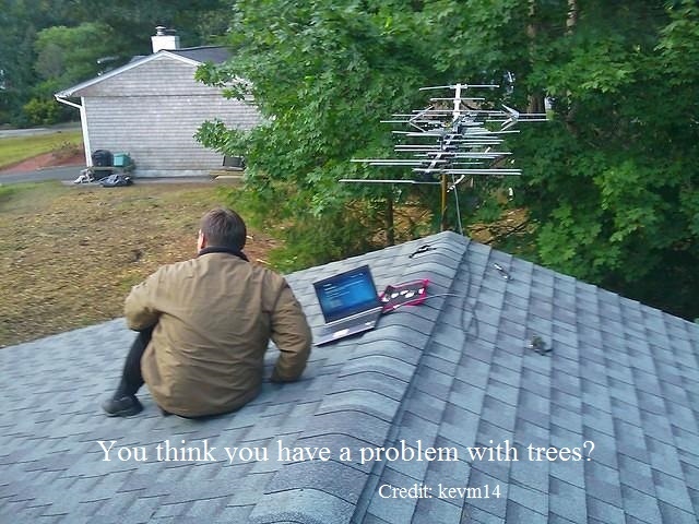

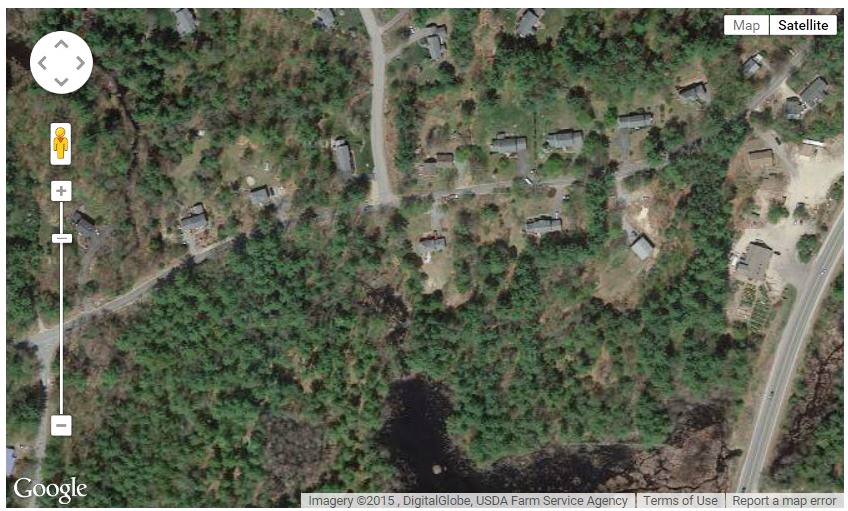

Thanks for the photos and another test without the preamp, giving you just WMUR.

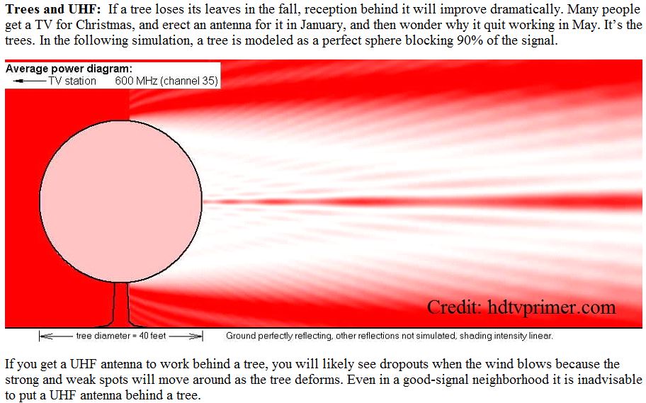

It's the TREES! The signals can't get through the trees. See attachment 1.
And most of them look like evergreens, so they are in the way all year, unlike deciduous that lose their leaves in the fall.
Heed ADTech's advice about trees:
http://forum.tvfool.com/showpost.php...90&postcount=3
http://forum.tvfool.com/showpost.php...26&postcount=2
I see a lot of trees in your area. See attachment 2.
I think your tree problem is worse than Kevin's:

Old 10-Sep-2015, 1:31 AM   #25
I see a trifecta of problems. The antenna is aimed point-blank at:
Trees
Power lines
Power transformer
I do not see a viable solution.

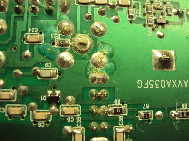

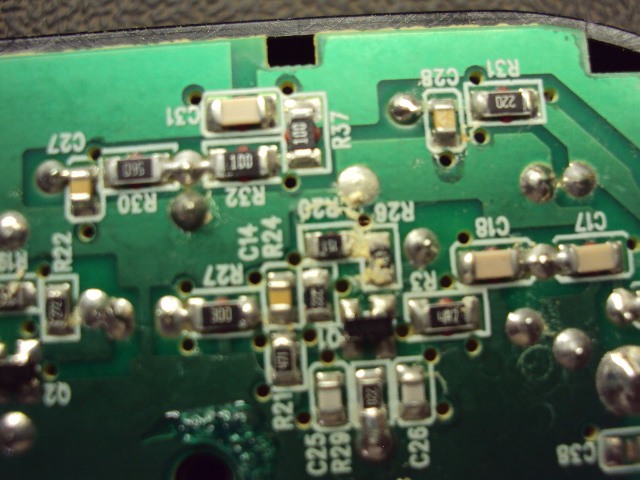

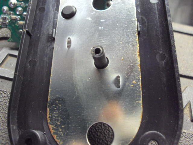

Issue resolved!!!
I should have re-read reply #4 from ADTech a few more times!!

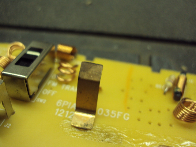

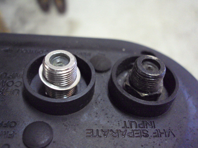

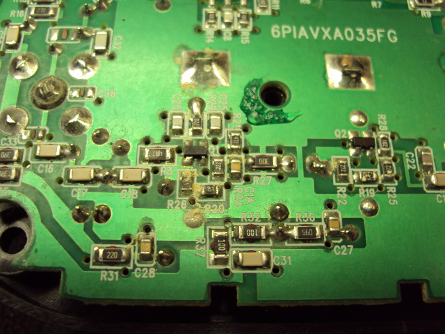

35' of coax and a 2-port splitter should amount to about 6 dB of insertion loss. If that is causing your loss of performance in the bedroom, there are other issues involved. [/QUOTE]
After removing the TVPRAMP1R from the system, I decided to look closer at it! The first hint that it might be the problem was the black mold on the unused "F" connector. When I opened it up I had more surprises! The ground plane where the tab rest also showed corrosion EG bad connections. Then I looked at the foil side of the board, the corrosion at a number of places was unbelievable! The coating was lifted and the traces were green with the white fuzz between contact areas on the components. I soda blasted both sides of the board (sorry no pix) The board came out like brand new. The soda just removed the loose coating along with the corrosion and did not damage or remove the good portion. I then sprayed the board with "HILL" lubricant (a professional equivalent to WD-40) it never dries and displaces water as well.
So the bottom line "There are other issues as well" was right on track!!! Thanks ADTech
I now have 24 viewable stations that I originally had downstairs on both sets with zero drop outs!
Thanks to all in helping resolve this problem.
Olnick

Old 11-Sep-2015, 3:05 PM   #27
Thanks for the report and the photos.
Good detective work!
You used your skills as a mechanic on this problem.
So, the intermittent connection was in the preamp, which is why you got the signals one day and not the next.
