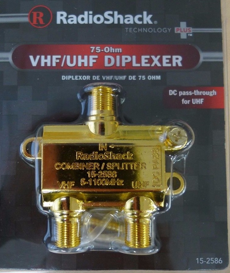

Yes, do it like my diagram in post 23. If the UVSJ diplexer went between the Amazon antenna and its power control box, you would need a special power passing UVSJ diplexer and you would still have only one output for a TV, so you would still need a splitter.
Some UVSJs pass DC power on the VHF side, and some pass DC power on the UHF side for a preamp. It so happens that the RS UVSJ passes power on the UHF side, but I still think you should put the UVSJ diplexer AFTER the Amazon power control box.

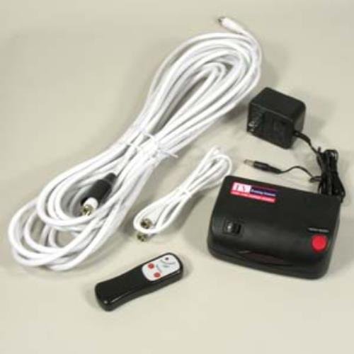

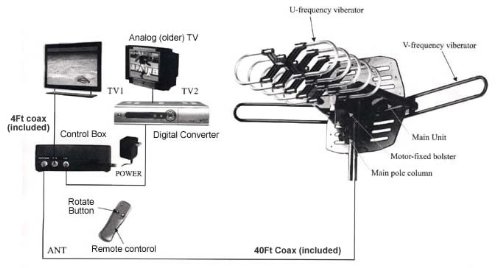

If your 150 mile Antenna control box looks like the one in the attachments, then it does have two outputs. I still suggest you do it like the diagram in post #23, but you can try it at you own risk like this:

If you can't find a Radio Shack store that has one, there are some 15-2586s on ebay; check the model number and age. Antennas Direct also sells a UHF/VHF diplexer that passes DC power on the UHF side:
https://www.antennasdirect.com/store...Combiners.html
