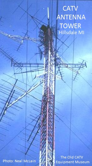

I am always amazed when someone wants a simple system that duplicates what a CATV system does with multiple antennas, amplifiers, and modulators costing thousands of dollars. You will need to cut back on your expectations and settle for improving one direction or be prepared to spend a lot of time and money building a system that does what you want.
http://theoldcatvequipmentmuseum.org...index.html#top
Try one direction first, and see what you get.

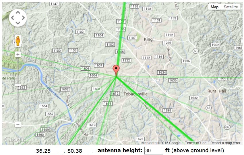

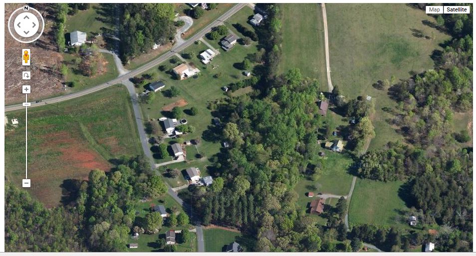

We can't guarantee that our advice will work. We only have the information that you have given us so far. There might be other factors that you haven't told us, like trees and buildings in the signal path that the tvfool report doesn't take into consideration with its computer simulation.
I don't know your exact location, but I see a lot of trees in the general area NW of the center of Tobaccoville. See the attachments. Did I get close?
scroll down to Trees and UHF

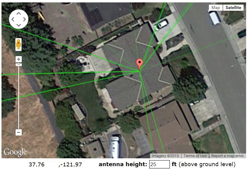

You can use the interactive map feature of tvfool to show the green signal lines that will help you aim your antenna, and to see what might be in the way. An example is in the third attachment. Enter your information here:
