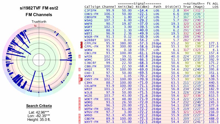

A 30 dB preamp probably isn't a good idea when you have several FM stations within 10 miles of you, two of which are 50 kW stations. See if you can swap the amp for one of the 15-20 dB models.

If you click on the pending button in your report you will see that you have not 2 but 3 local strong channels; CHCH on real channel 29 from London has been added.
ADTech suggested that you order the Juice preamp because he thought it would tolerate your strong local signals while providing amplification for the much weaker Detroit signals if you amplified UHF and VHF signals. As you found out the Juice is backordered because of a manufacturing parts shortage.
If you want to amplify just the C5 VHF signals and let the DB8E provide the extra gain for the UHF signals, you would need to use a UHF/VHF combiner AKA UVSJ, that would pass power to the VHF only amp. The AD combiner can't do that, but there are UVSJs that will as pointed out by Tim in post #29.
There is a test that you can do now to see if your preamp can receive Fox on real channel 7 if it is protected from the strong local UHF signals from Oil Springs and London.
I suggest you try just the C5 connected to the VHF input of the combiner with the DB8E not connected to the combiner.
C5 > combiner > preamp > coax > power inserter > tuner
You can also add an FM filter between the combiner and the input of the preamp if you think the FM filter in the preamp isn't enough to attenuate your strong local FM signals. See attachment for an FM report based on my estimate of your location. You can do your own report using your exact address to see how close I came (southern edge of Sherwood Village):
How does the DB8E do on the Detroit signals (Not including Fox) without the amp? Are you satisfied with the results?

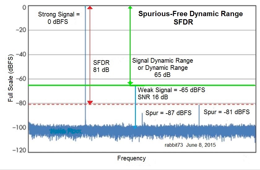

Does that make a difference?
Yes it does because the combiner protects the preamp from the strong UHF signals in the test that I suggested. The VHF input passes VHF signals but rejects UHF signals. The UHF input passes UHF signals and rejects VHF signals. Look at the UVSJ specs here:
http://www.hollandelectronics.com/ca...-Diplexers.pdf
I would prefer to keep the db8e amplified as it does help a few problematic channels come in reliably.
That would be a balancing act to provide a little more gain for UHF without overloading the preamp which would harm the reception of your weak signals. It has to do with the Dynamic Range which is the difference between your strongest signals and your weakest desired signals. When the preamp is overloaded by strong signals it produces spurious signals from IMD (Intermodulation Distortion) within the preamp that wipe out your weakest desired signals.
There is a limit to the Dynamic Range that your system can handle. When the Dynamic Range is too great you must resort to exotic (expensive) measures like custom filters and separate antennas for problem channels.
There is a technique that I use when without a preamp doesn't give enough gain and with a preamp gives too much gain. It is to insert an attenuator between the antenna and the input of the preamp to find the happy medium.
