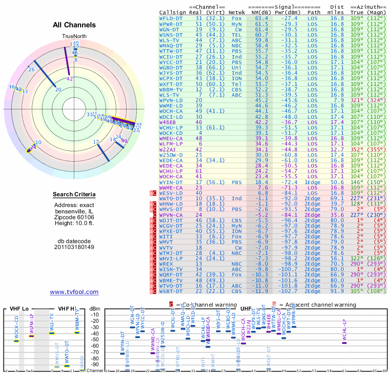

I fixed it . I moved teh antenna to 110 degrees and I shortened the cable to size, This seems to have helped. I wonder what will happen when I split the line for 4 tv's. Will it get worse? I guess Ill find out.

Point at the Sears tower. Five degrees either way is high precision in the case of this type antenna.

Yes.
There may be 20 degrees of mis-aiming before problems show up.
