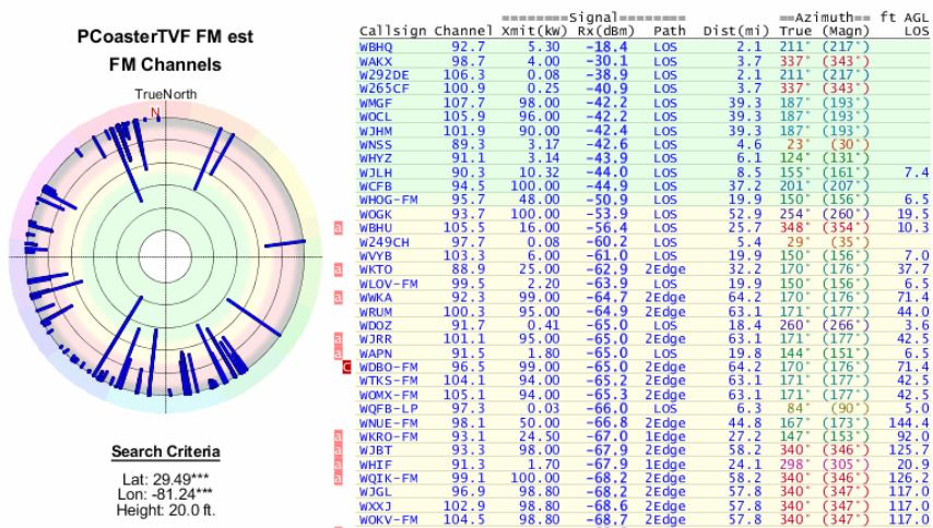

I don't have your exact address, but I think this FMFOOL report is more accurate than a zip report. It shows WBHQ 92.7 MHz 2.1 miles away at -18.4 dBm; attachment 1. I think an FM filter is called for to prevent interference, even if your preamp has one.
The RCA and the Juice preamps are more resistant to overload than the Anntennacraft 10G202. The RCA has an FM filter, the Juice doesn't. Put one or two in series between the antenna and the preamp input. Your strongest FM signals are 92.7 and 98.7 MHz. All FM filters are not equal (see attachment 4), but you have a choice based on those frequencies: Antennas Direct, MCM, and Radio Shack.

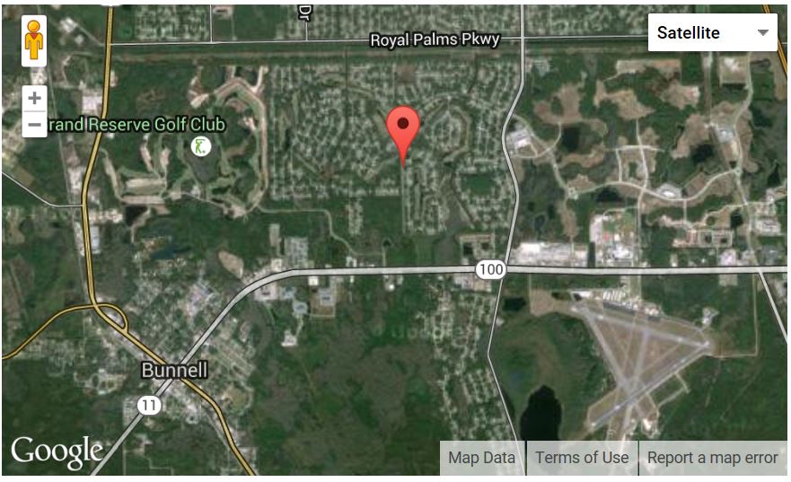

And I see a lot of trees, which are the enemy of UHF signals; attachment 2.
scroll down to Trees and UHF
And I see a highway that the signals have to cross; attachment 3.
(I also see an airfield, but we covered that.)
