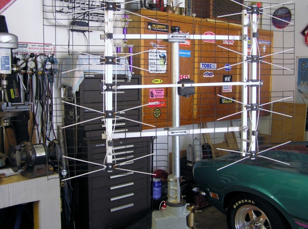

Here ya go ADTech.

Okay, that's a "standard" DB8.
You can likely rotate it AWAY from KOMU and KRCG and at least KRCG will come in fine. Maybe KOMU. The DB8 will pick up VHF much better of the back than the front as will most 8-bay bowties.
I'd try that before buying a VHF antenna and see how it works.
