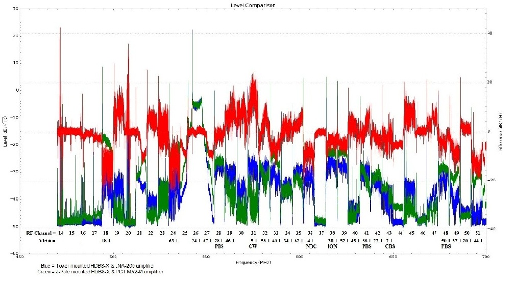

I bought one of the RTL2832U + R820T DVB-T Software Defined Radio (SDR) USB Tuner cards (for $8.72 from China) just after the first of the year and had so much fun with it that I bought two more (a pair & a spare?). They tune from ~22 MHz to 1.7 GHz and mine works really well just hooked to my TV antennas through a splitter. I use a free open source wide-band spectrum analyzer software program with it called RTLSDR Scanner. It has proven invaluable comparing different antenna & amplifier configurations. See the attached for a low res version of what it can do.
Even more fun is a program called SDR# (read SDR Sharp). This application also offers a Spectrum Analyzer display but additionally, can produce a Waterfall display or can simultaneously display both. When you see a signal on the FFT you can click on it, automatically tuning to it and opening the audio channel. It also lets you store frequencies (in groups) for later recall. I’ve already created groups for FM Broadcast, Weather Radio, VHF & UHF Air bands (I live 4 miles from March ARB), 10 Meter Ham band and 6 Meter, 2 Meter 220 and 440 MHz Amateur repeaters. This amazing program also demodulates CW, AM (including DSB, LSB & USB) and both Wide (FM broadcast) and Narrow band FM (police, fire & Amateur radio).
I use it all the time for listening to FM radio on my computer.

7 minutes is to scan from 470 MHz (channel 14) to 700 MHz just 2 MHz above channel 51. Narrower ranges take less time.
Some of the unique tuner devices available these days seem more promising.
I agree. The utility is in being able to capture a snapshot of the entire spectrum and compare it to another snapshot of the same chunk of spectrum. I often do this when I'm comparing two antennas or two different amplifiers.
