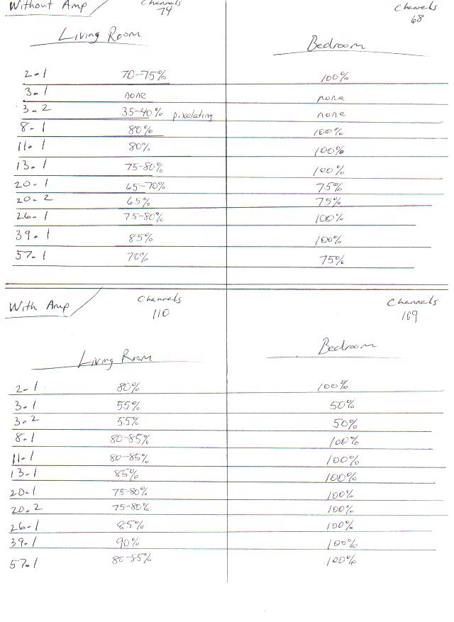

I finally set up my antenna
I finally set up my ant751r and rca preamp (tvpramp1r) this weekend. The antenna was mounted high up (25 ft) on my hardi plank chimney aimed at 169 degrees magnetic. I made a spreadsheet showing the reception percentages. Hopefully this data will help others in similar reception areas. I was picking up channel 3.1 and 3.2 from bryan/college station even though the antenna was facing nearly the opposite direction, towards sw Houston. Note the tv in my bedroom only displays in 25% increments. I am happy with the results and plan to cancel dishnetwork in about a month. I plan on buying another roku 3 and networking them both to a tablo dvr. Anyway, here are my results:
edit: virtual channel 2.1 is real channel 35, and 3.1 is real channel 50.
