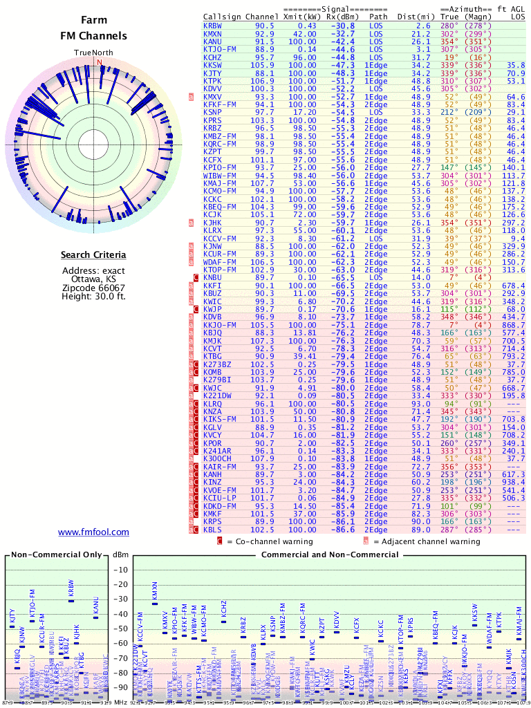

toadcat,
Unlike your TV Fool report, FM Fool resets so the link takes us to a page that needs all your information to complete. You can take a screen shot of your report and add it as an attachment for us if you like. Mainly, I just wanted you to be aware that any strong signals within the bandpass of your amplifier could overload it and they don't necessarily have to come from just TV stations.
I don't have a CM-7777, but from what I've read on the forums, they are more prone to overload than some of your other choices.

I guess it doesn't hurt to add the image.
So these FM signals will only interfere with the VHF antenna if/when I decide to add it and point towards Topeka. Which should be the stations in the 280deg to 310deg direction.
