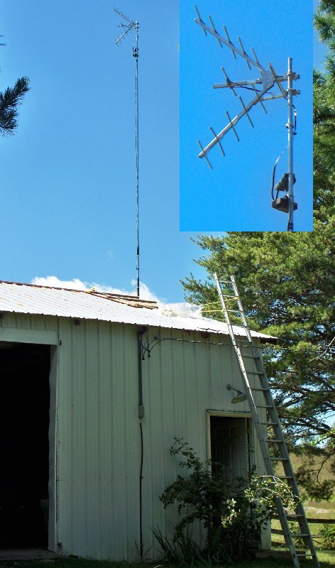

Jerrold/Wade VIP-306 for VHF-11
Previously mentioned was that the stacked YA-1713’s on the main tower were not much use after WKYT moved from Channel 13 to Channel 36. Then, it was realized that for part of the time, a Louisville KY VHF station could be received and was occasionally watchable. The station:
WBNA (ION) Channel 8, 24.5 kW, at ~80 miles, TVfool Noise Margin -7.0 dB
And also interesting, for short periods of times, Louisville’s WHAS channel 11 (16.4 kW, at 101 miles) could be received, but was not actually watchable.
The signal goodness indication on a CM-7000 DTV converter was calibrated using a Signal Level Meter (~1.5 dB per each 10% indication for channel 11). This calibration of CM-7000 was used to help evaluate the two stations’ signals, hoping to make antenna changes for potentially better reception. For several weeks, reception of these two stations was checked daily.
An additional two YA-1713’s were purchased for possibility of a installing a quad stacked arrangement of YA-1713’s.
Analysis of signal data suggested:
An additional gain of 7 dB, above that provided by the stacked YA-1713’s, may be required for reliable reception of WHAS-11.
This required amount of increased gain (7 dB) essentially ruled out a quad stack of YA-1713’s.
A quad stack of YA-1713s (2 horizontal, vertically stacked above 2 horizontal, or even a diamond stacked quad) would at best provide ~3dB gain above a dual stack.
At the time, the highest gain for commercially available VHF antenna was Jerrold/Wade VIP-306 (specified gain of 12 dB on Channel 11). The VIP-307 version had a bit more gain but was no longer available.
That VIP-306 gain listing was dBd. In the late 1960's when the VIP series were designed, computer simulation (dBi) was virtually non-existant. So dB values were commonly provided in dB, as actually measured, with respect to a dipole (dBd).
A pair of VIP-306’s was purchased for evaluation and potentially for stacking.
Below, is an image of a single VIP-306 installed at the test location, aimed towards the main tower.
Over the next few weeks, other VHF antenna configurations were mounted on the test mast and reception observed.

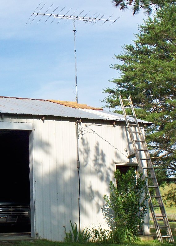

Longer Reinforced Mast
If higher gain antennas were to occupy the top position on the tower, then a taller mast may be required. For maximum stacking gain, individual antennas with higher gain require increased stack spacing. At that time, the existing mast was 10.5 feet of SS-20 (heavy duty), 1 & 3/8 inch outer diameter top fence rail.
Realizing that if a longer mast was ever bent by wind force, with unreachable antennas installed, it might be difficult to remove.
To maintain highest rigidity and minimize weight, a mast was configured of three parts:
· Full-length Outer – 15.5 feet of SS-20, 1 & 3/8 inch outer diameter
· Inner – 10 feet of Schedule 40, 1.064 inch outer diameter
· Lower-Outer - 6.5 feet EMT, 1.5 inch outer diameter.
The mast thickness were:
· Bottom portion was 3 pipes thick (EMT, SS-20, & Sch 40)
· Mid-section was 2 pipes thick (SS-20 & Sch 40)
· Top portion consisted of one pipe (SS-20)
The Inner was positioned inside the Full-length Outer, such that it did not reach the top ~ 4.5 feet. In other words, the top 4.5 feet consisted of only the SS-20 pipe. Also, the Inner pipe did not extend all the way to the mast bottom, but there was pipe overlap inside the tower.
The Lower Outer (EMT) was positioned to reinforce the lower part of the mast, up to ~ 4 feet above the tower top.
The Full-length and the Inner mast were assembled with stainless steel screws. The Lower-outer was to be added after the assembly was in place. The assembled mast (without antennas) weighed 35 pounds.
A sort of a ‘gin pole’ (lightweight pipe with upper loop) was temporarily fastened to the tower top as an aid during installation. The top end of mast was fed up through the loop to help balance and stabilize it during installation (especially with air movement). This additional stability was probably most critical when inserting the lower end of mast into the tower top.
Below is an image of the mast on the tower without the Lower-Outer portion. Later when antennas and the Lower-Outer mast portion were installed, the mast was raised a bit higher. The install support ‘gin pole’, is also shown but was later removed.

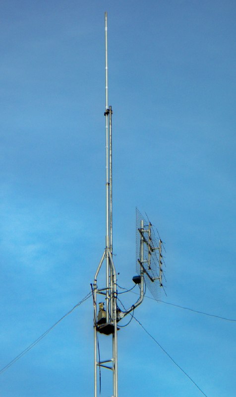

Custom Corner Reflector
The Channel Master 8-bay coupled through a CM-7777 and a Join-tenna provided reliable reception of WCTE-22 (~ 65 miles distant in Tennessee).
It was noticed that Channel 23 WPXK, also in Tennessee, might also be receivable. WPXK-23 is separated by about 54 degrees in azimuth from WCTE-22. If both stations were receivable, they could probably be accommodated by the single existing Join-tenna.
In addition, a third station Tennessee station, WBXX-20 located in azimuth between WCTE-22 and WPXK-23. If channels 22 and 23 were receivable, then due to higher signal strength of WBXX-20, it might be pushed through the same Join-tenna.

A wide-beamwidth antenna with moderate gain could be a solution. Some candidates:
· Channel Master CM-4221
· Antennas Direct ClearStream C2
· Custom corner reflector (CR)
Another option could have been something like an Antennas Direct ClearStream C4 or Winegard HD-8800 with:
· Relative phase of right–left (RL) feed lines reversed
· RL Bay spacing optimized for split-beam lobes at 54 degrees separation
Some features of a custom CR antenna were appealing, one of which was it could be optimized for narrow range of channels around channel 22.
First, a CR backbone was retrieved from a scrap Antennacraft all-channel antenna. Then reflector elements were scrounged. Shorter reflector elements can yield wide beamwidth, but compromise some gain. For a few reasons, a moderately short reflector length of 16” was selected. The driven element was made from longer trimmed-to-length elements and supported by recycled insulators.
When the prototype was assembled, it was simulated in a computer model using Arie Voor’s 4NEC2 software. One objective was to get every tenth of dB gain while maintaining a good match to 300 Ohms. Since wide-beamwidth antennas usually have only moderate gain, then in this case it was important to have a good impedance match to optimize efficiency.
The prototype was tested with three preamps:
· CM-7777 with low loss balun
· CM-0264 (internal balun)
· Blonder Tongue Vaulter III (internal balun)
The image below shows the prototype and a couple of preamps on the test mast.
The main variables in optimization with 4NEC2 software were:
· Driven element length,
· Position of driven element relative to apex
· Position of reflector elements near apex
After a few rounds of optimization; computer simulations, trimming, and on-the-mast testing, the CM-0264 was chosen as the preamplifier. The final tweak on the main tower was trimming the transmission line between the CR and the preamplifier for maximum signal.
The image below shows the installed corner reflector on the main tower. Most obvious change in the two photos is the position of the two reflector elements near the apex.
With antenna direction at a compromise between the two weaker signals, the signal strength was not high on either of them. Fortunately, for all three signals being 1-Edge diffraction, their signal strengths were relatively stable, especially considering the distance of 65-75 miles. In normal viewing, no TV image dropouts have been seen or reported. Image dropouts have been seen when severe thunderstorms were between the stations and the receiving location.
A CM-0264 preamplifier was modified to replace its internal balun with an internal half-wave coaxial loop balun. In tests, the modified CM-0264 yielded ~1dB more S/N margin for all three stations. It has not been installed.
Early in 2011, WCTE-22 increased power to 200 kW (from 57 kW). This power increase allowed a re-positioning of the antenna in azimuth, with improved signal strength levels for all three stations.

Test Transmitter - Crystal Oscillator
Returning to VHF antenna tests, recall that an objective was to receive WBNA-8 and WHAS-11 from Louisville KY at distances of 70 and 101 miles. A project was initiated to determine if an antenna arrangement could make such reception possible.
TVfool report (both stations listed as 2-Edge):
Code:
		Noise Margin	Distance (miles)
WBNA-8           -7.2 dB	79.3
WHAS-11		-14.9 dB	101.1
A few antennas were compared at the test mast location (garage); Jerrold/Wade VIP-306, Channel Master Crossfire CM-3610, stacked pair of Winegard YA-1713, and a channel-cut Wade antenna.
Other high gain antennas were available, but only single units. It became fairly clear that no single antenna would suffice.
WHAS was listed as 2-edge and at the test site the signal was almost continuously variable. The actual signal strength, on an analog meter, fluctuated ~15 dB within something like 30 to 45 seconds. Portions of the WHAS 6 MHz spectrum varied independently.
The signal variation was such that antenna gain differences of maybe 1 or 2 dB were not visible.
It became apparent that, at this location, there were no commercial VHF signals strong enough or stable enough for definitive signal evaluation. Actually, there were no closer or stronger VHF signals at all. A local signal source was needed.
At the time in 2010, the signal synthesizer discussed in earlier post had not been constructed. So, a 20 MHz crystal oscillator was built to use as a VHF transmitter. The 9th and 10th harmonic of the crystal frequency provided test signals for channel 8 (180-186 MHz) and Channel 11 (198-204 MHz). The signals from the crystal oscillator were fed to a transmitting antenna at the main tower.
The transmitting antenna was a portion of a YA-1713 mounted on reverse side of CM-4251 on the main tower. It was fed by coax from the crystal oscillator located on the ground. The transmit antenna was aimed toward the test mast (at the garage). The signal was then received by the antenna-under-test mounted at the test mast location. Height of receiving test antenna was adjusted to be ~ level with the transmit antenna (~45 ft. AGL).
The above arrangement provided stable signals for use in gain comparisons between candidate VHF antennas.
The image below shows the upper-VHF transmit test antenna.
Later, a crystal oscillator was built that could have provided UHF signals, but it was determined that a synthesizer was a better solution.
The crystal oscillator was used as a reference transmitter in tests throughout 2010, until the synthesizer was constructed in early 2011.

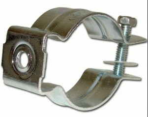

Originally Posted by Stereocraig View Post
Tripelo.
Do you make your own clamps for the tower verticals, or is there something commercially available.
I have used clamps from my drum rack, but don't trust them for durability.
A picture would be nice, if you're able to provide one.
Sorry, don't have any photos that I know of. Presently, I am not at the main tower site to take any photos.
Mostly use recycled antenna manufacturer clamps (the ones that come with antennas).
However, a pair of conduit clamps back-to-back makes a pretty good mast-to-mast or mast-to-tower leg clamp for light masts with light antennas. For mast sizes up to about 1 & 3/8 inches, the clamp size, not sure but think, is labeled 1 inch.
This labeling results from pipes being dimensioned according to inside diameter whereas mostly antenna installations are involving outer diameters (tubing convention).
This photo, a generic conduit clamp from the web, represents the type of clamp discussed.
Look for heavy duty clamps, Lowes and Home Depot here don't seem to have the heavier grades. Probably electrical supply or old fashioned hardware store might be good places to find heavy clamps.
Bolt two clamps together, through the hole shown in the left of the image above. A 1/2 inch long, 5/16 inch bolt with two thick washers and a nut works well to hold two clamps back-to-back. If the bolt is much longer than 1/2 inch it will interfere with the masts.
This arrangement has an advantage in that it allows two pipes to be connected regardless or their orientation (horizontal or vertical or some angle).
Almost any mounting using these clamps requires four clamps (two pair). But maybe in a heavier installation more clamps could suffice.
