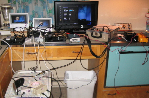

I have had some personal experience with this problem and made some tests to figure it out:
http://www.avsforum.com/t/1255983/vo...#post_18772087

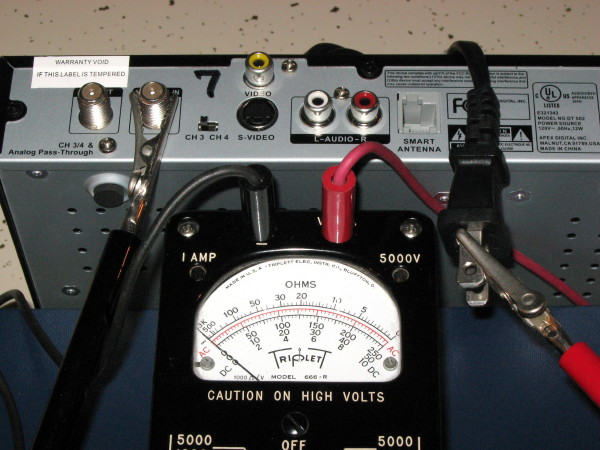

If you look at the pdf of Leakage Current Tests in my previous post, you will see that the 2 Apex CECBs, the 2 8-inch TVs, and the Sony TV all had leakage current even though their 2-wire polarized plugs were properly inserted into a 3-wire outlet strip that was connected to a working 3-wire receptacle. It was only when I grounded the common coax wire that the leakage current went to zero as measured by my Simpson 229 Leakage Current Tester.
Have you made any resistance measurements with an ohmmeter between the threaded collar of the antenna connector and the wide blade (neutral) of the plug on a 2-wire power cord? If what you say is true, then the resistance would be very low, almost zero ohms. But, it's not.

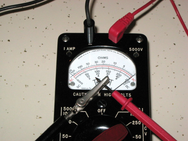

Attachment No. 1 shows my ohmmeter with the probes connected together for a short circuit. The OHMS scale reads zero ohms. Note that for the ohms scale ZERO is at the right end and open circuit is at the left end with an infinity symbol.
Attachment No. 2 shows my ohmmeter connected to my CECB No. 7, which is an Apex DT502. The black probe is connected to the threaded ant connector and the red probe is connected to the wide blade (neutral) of the 2-wire power plug. The meter reads an open circuit, which means that the coax IS NOT connected to ground through the power cord.
