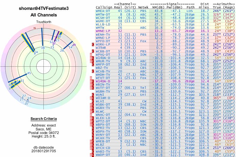

Originally Posted by shoman94 View Post
Your first estimate is more accurate but change the height to 25ft.
Thank you. First estimated location now at 25 ft:
http://www.tvfool.com/?option=com_wr...9038fbae7e20d8
Yup, it matches now.

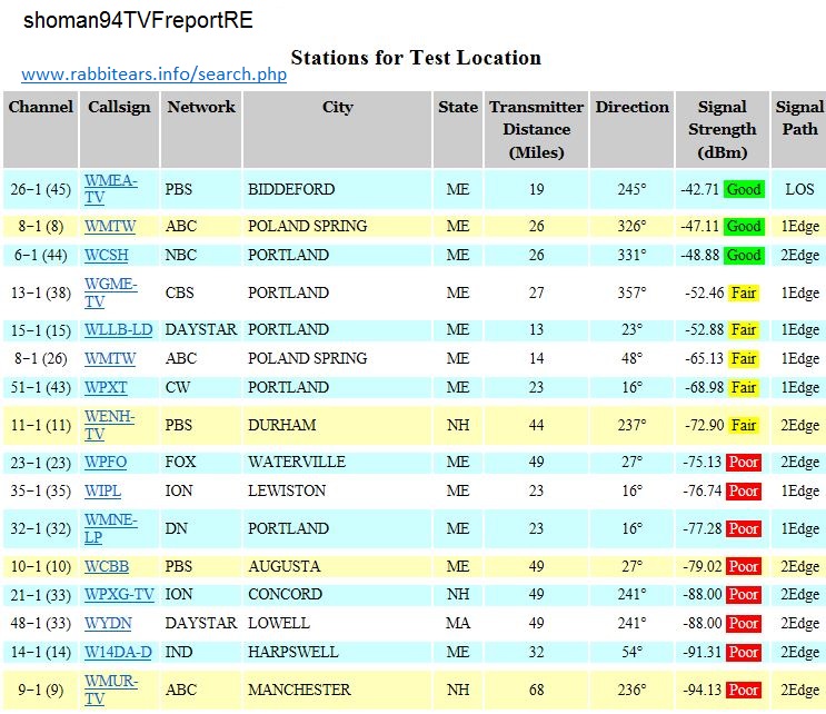

This is a double check with a report from rabbitears.info because the TVFool database has some errors:

You do have two FM transmitters from the ENE only 3.2 miles away, but they don't look like a serious threat because they are not high power.

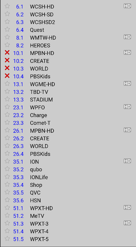

I don't know. I'm aimed at about 10 degrees and attached are the channels I get. This antenna had a pretty wide pattern. I thought about getting a db8e and offset the panels but, it's a bit large.
26 has been giving me some trouble as well coming from the back side.....
