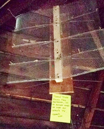

Good news!
Turns out the landlord replaced the little windows in the attic and threw my antenna on the floor when he changed the one on the west end I had the antenna hung in.
I put on the screen reflector and put it in the rafters and this time I pointed it 320 degrees and about 5 degrees up since I'm only 2.5 miles from the towers.
Now we get all the channels in that direction at 100% solid without budging!!
When it was in the window facing 270 degrees, it was getting mid 60s with occasional pixilation.
Not sure if it was the reflector, aiming direction or the slight looking up that did the trick but she's a happy Packer fan again.
Thanks again guys for the advice and I've been reading up on this and the gray- Hoverman antennas and might start a new thread to improve my setup at home.

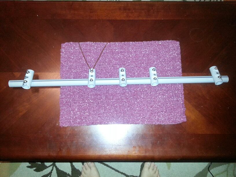

Here's a pic or two of the zero cost unit:
Lexpilot is offline   Reply With Quote

Guess I can only put one pic in a post?

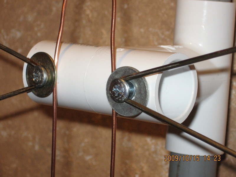

I edited your two photos, added them both as an attachment to this post, and made them show in this post.
You have made a good start with your DIY antenna. On future DIY antennas, the elements should not be directly attached to wood. They should be insulated from the wood because the ends of the elements where they are attached to the vertical feed lines are high impedance points sensitive to loss.
I don't think the original plans for your antenna give the vertical spacing for the distance between the bays. It should be about the same as the element length on each side. The M4 antenna (for mid-band) designed by mclapp has 9-1/2" elements on each side with a vertical spacing between the bays of 9".

Yes the plans for the antenna I used showed the spacing for the elements.
The vertical feed lines are .o41 stainless safety wire and are wrapped around the screws under a washer holding the elements to the wood. There should be no loss between the feed wires and elements.

Old 31-Aug-2016, 3:10 AM   #20
Lexpilot
Join Date: Aug 2016
Posts: 11
Thanks rick, I know wet wood can conduct.
This actual piece is from an antique book shelf and is bone dry. I would bet if I checked it with my megger it would have insulating properties as good as PVC.
I'm not sure if I should start a new thread but I'm using the uhf portion on a combination unit I cut apart and it works pretty well. I'm 35 miles away and there is terrain and trees blocking the line of site to the transmission towers. It seems when it's windy, and the trees are moving I get occasional pixilation and less than optimal signal strength.
I have the antenna on a pole as high as I dare go and it is supported very well with guy wires so I know it is not moving on the wind.
My question is: Would one of these flat bay type or the Gray/Hoverman give better results?
I do have a CM7777 amp on the antenna and coax inside. It will not even display without the amp.i normally see mid 70% on the tv signal meter.
Should I start a new thread with the data report?
Thanks,
Dan
