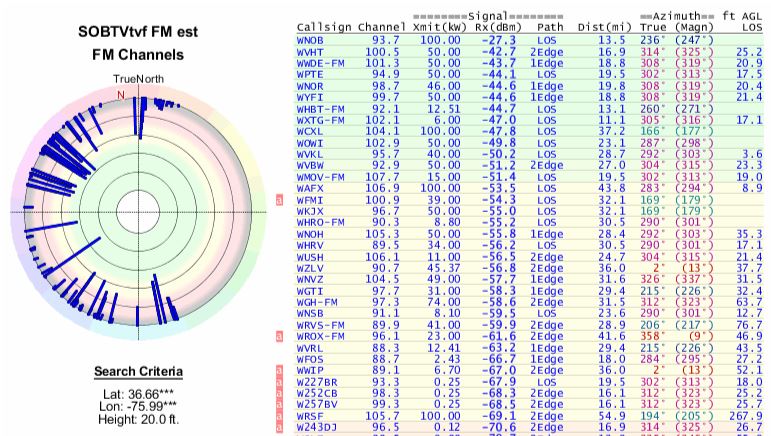

There is no magic antenna that will "see" through trees. Sometimes it is possible to mount the antenna in the best location you have, and add a preamp if the signals are weaker because of the trees. Attachment 1 shows how a tree will damage a signal and attachment 2 shows many trees in your area, but I don't have your exact address.
