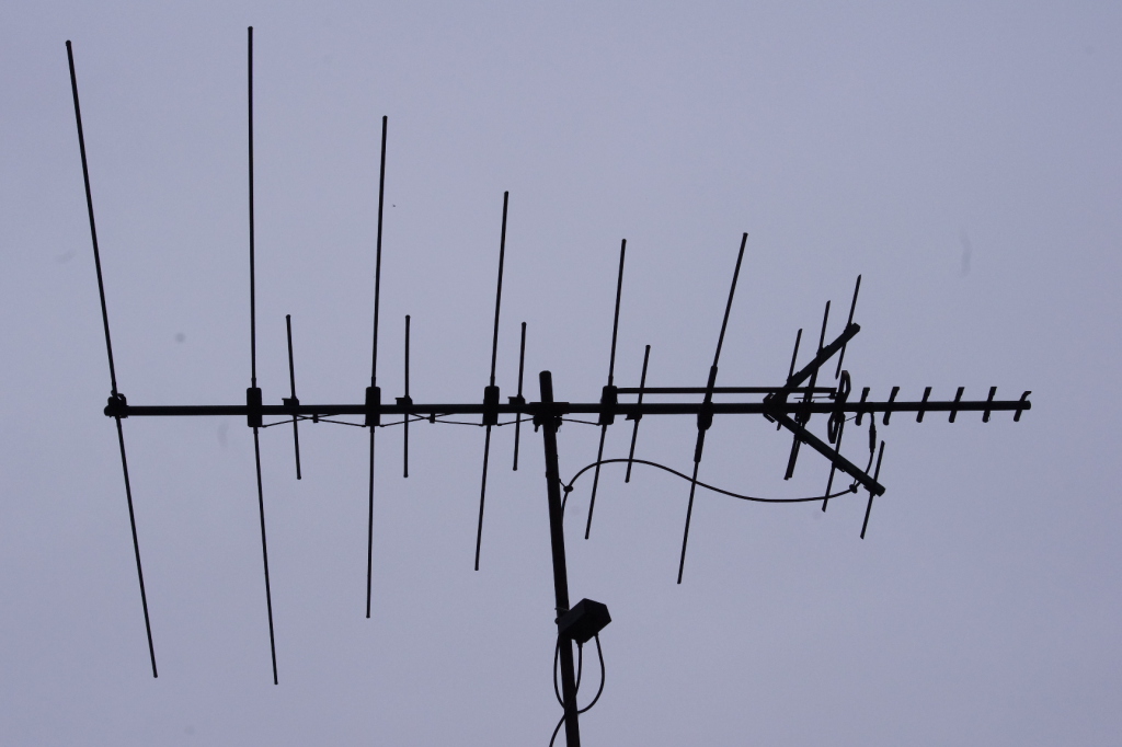

As for the antenna I don't know what model it is, but it looks like an Antenna Craft C290 with only 10 "rear " elements and without the smaller elements between the larger ones at the rear.

For those that wanted a picture of my antenna.

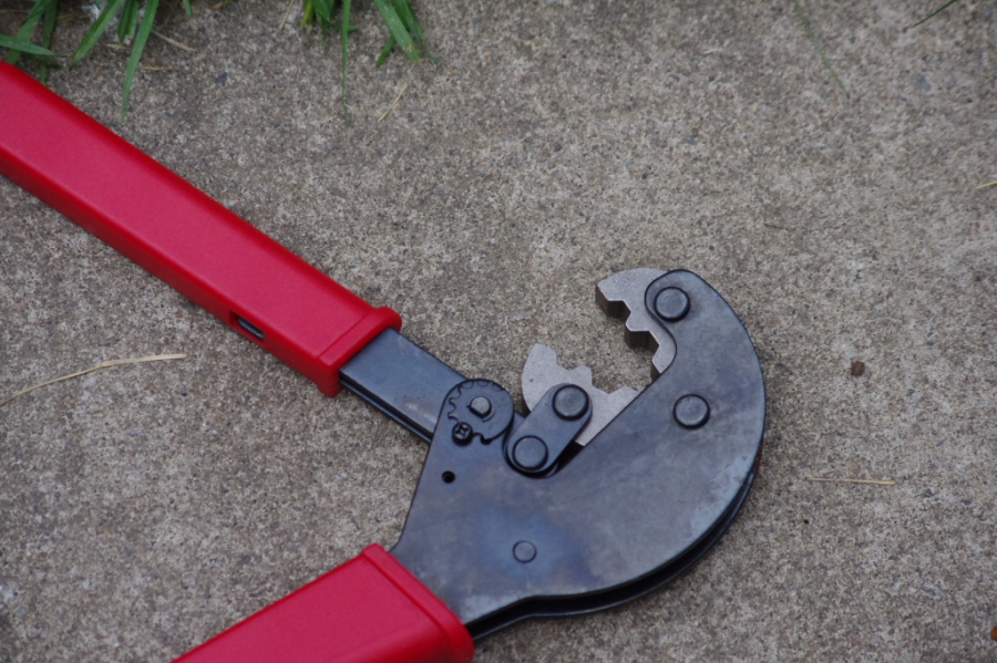

Question about compression coaxial fittings.
This is my crimper. Will it work for the above mentioned fittings?

Old 15-Jun-2014, 5:50 PM   #17
Nope.
Go to Home Depot's website and search for "coaxial cable compression tool". Note that two/three layer shielded coax uses different connectors than does quad shield, so match up to what your coax cable on hand is.
