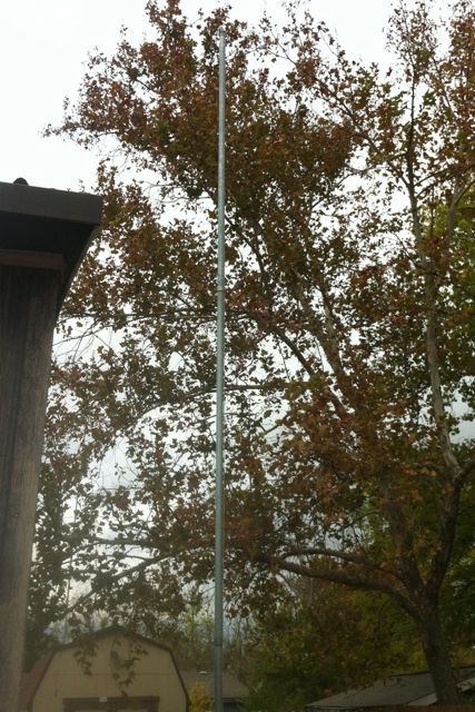

Good day...
Santa (more often referred to as wife) has approved an HD antenna
http://www.tvfool.com/?option=com_wr...cc49f11d078b97
Zip 78669
PCT International CM2016 Channel Master Television Antenna
Single TV Samsung plasma
Targeted stations N.E. KVUE to KEYE
I have two mounting options...
15ft to 25ft Ridged conduit, a 50ft cable run (preferred). The flag pole jpg is taken facing S.W. The background is not in LOS.
Or, a telescoping mast with three guide wires, which currently has a small wireless internet radio. This would be close to 200 ft cable run. It's current height must be 40ft. There's another ring for a second set of guide wires. I think it could go another 10ft.
If you can help, it would be greatly appreciated.

KEYE-DT REAL UHF Digital channel 43 , virtual number (42.1-2) CBS and Telemundo.
KVUE-DT REAL UHF Digital channel 33 , virtual number (24.1-2) ABC and Estrella Tv.
Are both at 118 degree magnetic compass direction , along with the rest of the group of Tv stations in that direction , South East.
I recommend aim the CM2016 antenna at about 118 degree magnetic compass direction.
The Digital Tv stations/channels in the Green and Yellow reception zones of the tvfool Current Plus Pending Applications Included radar report plot and channel list are strong signal strength.
______________________________________________
KAKW channel 13 Univision.
KBVO channel 27 MyNetwork.
KCWX channel 5 MyNetwork and This Tv.
Are Strong Signal Strength and will also be received.
No preamplifier is required.
For 1 Tv connected use no splitter.
For 2 Tv's connected use a common simple 2 way splitter.
For 3 Tv's connected use a common simple 3 way splitter.
You can mount the CM2016 on the guy wired pole or a roof mount will also work.
Here are some roof top type antenna mounts , http://www.ronard.com/909911.html , http://www.ronard.com/34424560.html , http://www.ronard.com/ychim.html , http://www.ronard.com.
Buy the ronard antenna mounts at solidsignal.com by typing the word ronard in the solidsignal search box.
Here are some places to buy , http://www.solidsignal.com , http://www.amazon.com , http://www.channelmasterstore.com.
As always , trees and tree leaves do a real fine job of reducing or blocking Tv reception and so do buildings and other obstructions including your own house.
It is best to install the CM2016 antenna at a location that has the least amount to no amount of obstructions of any type or kind in the directions of reception including your own house.
The Tv/s Must Channel Scan for the Digital Broadcast Tv Channels , sometimes named the 'Air Channels' or 'Antenna Channels' in the Tv setup menu because the Tv transmissions travel through the air from the transmitting antenna to the receiving antenna.
