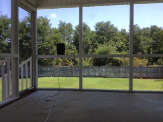

I experimented with an indoor flat antenna (clearstream micron) and found it did very well out on the porch adjacent to our living room (see attached pics). It's about 20 feet from the HDTV inside, facing east. The only station I have not been able to pick up is the NBC affiliate. I'm thinking to get an outdoor antenna and mount it outside the porch screen on one of the vertical posts. The top of the porch is ~10 feet above ground. There is an exterior outlet available should I need a preamp. Any suggestions on what to get?
My signal analysis is located here:

BTW, I'm able to pick up RTV with the indoor located out on the porch.

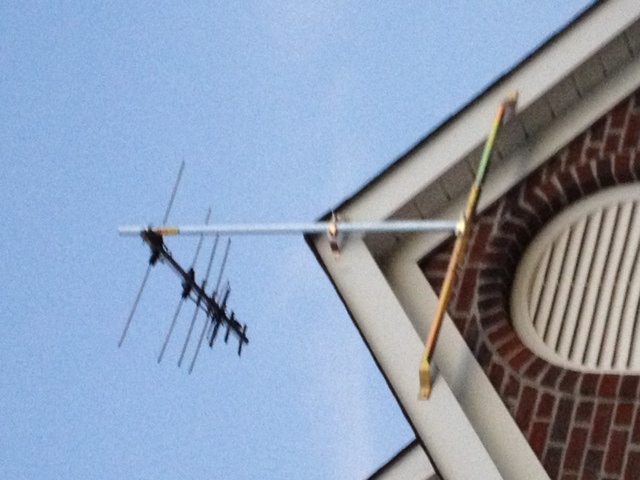

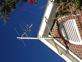

I tested the ANT751 antenna in the attic and was able to pick up all the stations listed in the above post, but decided to mount it on the eave directly above the cable box. Ran out of daylight, so I'll run the coax to the box in the morning.
Is it necessary to caulk around the lag bolts?
Calking seems like inexpensive insurance against needless water damage. I've calked every hole in my siding. Even if the hole does not pass through, it's good to keep water out of the wood... just to keep paint from peeling or blistering.
Good looking brick home.
Enjoy

Caulking is good. Water has a way of getting into places you do not think it will go.
Back the screws out on the eave mount brackets , put some caulk behind the bracket and tighten the bracket down.
Nice looking install , Free Tv , thats Ok.

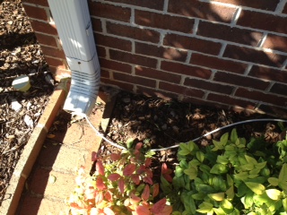

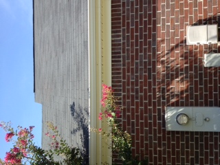

I ran the coax yesterday (2 drip loops, one below antenna and the other at the base of the mast) and found the best alignment of the antenna at 90deg (magn). WAFF (NBC) is the only station at 99deg. and comes in fine. WAAY (ABC) has a weak signal and I was not able to improve it at either direction.
Should I elevate the coax running between the downspout (photo 2) and cable box (photo 3)?
The coax is grounded at the box with a grounding block.

That is a great looking installation.
The coax will be fine , in with the flowers and wood chips.
And the coax can be elevated if you like.
I would leave it with the flowers and wood chips.
